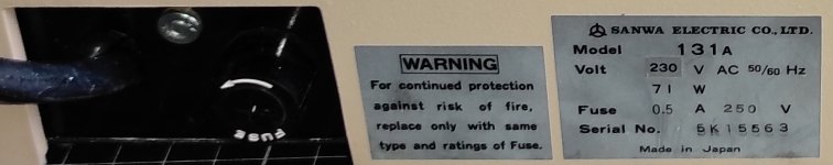

Hello everyone,
I'm new to this group and I'm asking for help: is anyone familiar with this computer marked SANWA 131A, made in Japan?
I'm very curious because it only has an CANON FDD, a LCD display, and a 40-character dot matrix printer with no I/O ports other than a Centronics port.
The keyboard appears to have a German layout.
The processor is a SHARP Z80A-CPU-0 with 64KB RAM and two 2732 EPROMs.
I don't have a floppy disk and I don't even know the operating system (CP/M or MSX-DOS?)
I couldn't find anything online.
Thanks to anyone who can help me.

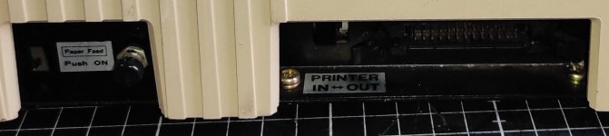

That could be a valid hypothesis.
I'm attaching the only port present, "PRINTER IN-OUT."
Perhaps it also captured text sent to a Centronics printer.
I can't explain the display's size, only 40 characters and not 80.
The most recent chips date back to 1985.

What is the dark grey part top-left of the first picture? It looks like an output for a paper roll. Maybe it is a label printer. That could explain the small screen.
Regarding the printer connector at the back: it seems to be a male so I assume it is a serial port, not Centronics.

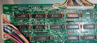

Yes, it's a nice unbranded 7-pin printer with the "R-7HB" marking on its PCB.
I'm a novice, but I think there are too many wire-connections to the printer for it to be serial.PRINTER.jpgPrinter MB Connection.jpg
Yes, that type of connector is more than likely an RS232 (or 20 mA current loop) interface.

I removed the printer connector board.
From the PCB, I don't think it's an RS232 or 20 mA current loop interface.
I see an 8-bit bus and think it might be a Centronics parallel interface.
Correct me if I'm talking nonsense: I'm here to learn from the experts. :)

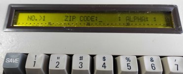

Solved!
I've finally managedData Entry.jpg to understand and get this mysterious computer working.
Thanks to everyone who responded: every reply helped me better focus on the problem.
If it can be of help to others, the solution came to me via GeminI after I handled the questions to analyze the Z80 firmware (unusually large) and the events via keyboard input.
I thus discovered that the SANWA 131A computer is a label manager and printer (for shipping) with the archive stored on floppy disk and that it doesn't use an operating system.
By analyzing the floppy disk drive settings, I also discovered that the floppy disk (DS-DD) must be preformatted in CP/M.
I still haven't been able to print, but it's not a big problem now.
