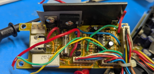

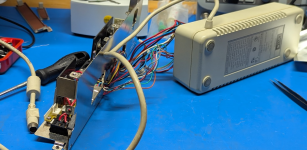

Picked up a DataWorld LP320 (a rebranded Nan Tan 8100 as I understand it) from an estate sale, kept in a nice carrying back in a basement for many years, power brick included, but didn't power on. Pasted image 20260314222312.png
Did some preliminary maintenance (notably removed the CMOS battery, fortunately not very corroded, board underneath was fine). I was bummed about the power supply not working, it read +15.6V on the male pins, but when plugged in the voltage was floating and it couldn't drive anything. This led me to reverse engineering the whole power input board (though not the separate power converter board that actually derives the +12V, +5V, and -23V rails from the +15V input) in hopes of tracking down the issue. Also I like reverse engineering.

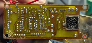

The board I investigated:
You can overlay this mirrored and adjusted version of the bottom side with the top side photo above:

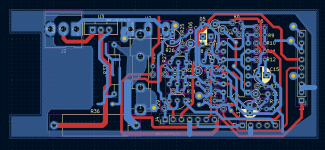

The PCB, mostly there but with some wrong footprints (laziness) and missing connections (that are however included in the schematic):
The comparator section of the circuit seems like mostly power-good/over-voltage/under-voltage alerts. Haven't looked enough at the transistor section. On my board the big power resistor R36 was open, but since J2 doesn't have any connection it shouldn't matter to functionality.

Anyway, fun as this was, the problem ended up being with the PCB power connector not having any connection to ground. Only pins 4 and 6 were grounded, but those didn't have any connection in the cable, very confusing. Also confusing that the +15V was carried on two 22awg wires (red and black) in the cable, while the ground is presumably the single white wire (also 22awg), something else must be going on.
