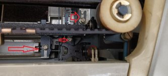

Machine keeps running without stopping:
Mostly it is a lever right side keyboard to the rest of mechanics that need to be adjusted.
Look down the tooth belt right side and notice a horizontal lever from keyboard .
Beware its a very narrow adjustment and due to shipping that machine this could be your problem.

So, part two. Tested selector trip mechanism and seems to work just fine — magnet I’m not too sure about, but it doesn’t seem to me like it’s engaged. Here’s a video of that: https://streamable.com/p8vowm
Otherwise I’m not sure if the selector mechanism is missing something or if I’m even looking in the wrong area for that.
Otherwise, for the adjustment under the spacing belt I’m not too sure which adjustment you mean, unless you mean the H bracket.
Indeed that mechanism start and stops the clutch ,as I recall.
When a key is pressed it starts the print mechanism and if print mechanism is ready print the character it
free the key's again for operating next key.
A ASR33 I had to repair it kept printing so never stopped,this was the issue to solve.
Also if moved this adjustment to far other way it never starts printing.
Due to fact the keyboard can move according the whole printer a little bit.
Or when unit is been apart.
By shipping by mail , you said, there could be a shift from whole printer unit.
You could also look for the 4 bolts that holds whole printer unit and loosen up and shift whole printer a bit.
See if ,in local mode, the machine starts print by it self.
Then you know you have to adjust this part of machine.
Can't find this adjustment right now in the adjustment manuals, but it should be noticed there.

I don’t know if it’s just me, but it looks like I might be missing some kind of brace or bracket for the middle screw you pointed out. Is there something that is needed there?

Indeed looks like you miss something that is present in my ASR33.
But also be ware the lot of modifications, changes made etc etc.
Not 1 machine is the same.
Dive into the many manuals and start looking.
