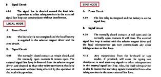

From what I recall, The LOCAL position simply disconnects the serial data in/out from the interface board (current loop or whatever), and then connects OUT to IN (internally). I seem to recall that the keyboard (and optional reader) and answerback drum are pretty much always connected to the distributor, such that pressing a key will always activate the distributor and you should hear the distinctive "buzz-whirr" of it "sending". I also seem to recall that the typing unit and optional punch are also connected to the receive mechanics. When the START bit begins, it should engage all the mechanics to assemble the data bits into some mechanical positioning of the bars and then a "print" is done on the STOP bits. The noise of the printing usually drowns out any noise from sending.
So, to my recollection, if the receive line is stabilized (so no noise is present) you should hear nothing but the spinning motor in LINE mode, and pressing a key should result in that buzz-whirr noise of the distributor. If it is not working in LOCAL mode, you might need to go to LINE mode and first determine that sending is working, then trouble-shoot receiving.
All 33's I've worked on will chatter in line mode if loop is open. Won't hit print wheel or advance.
Sure, that's just "noise" causing false START bits and most of the time the character "received" ends up being unprintable. That's why something needs to be done to stabilize the receive line. I'm not sure what the appropriate method is for current loop, though probably just a correctly-sized resistor across the inputs. Although, if current is required to cause a MARK line condition, then something more may be needed (SPACE line condition will look like a START bit). For RS-232, that's not usually required, but a pull-up resistor (or maybe just to ground) might be needed if the input has too much noise.
This Teletype schematic makes me think that just a modest resistor across the inputs should quiet it down, unless I have MARK and SPACE reversed. I assume that the selector magnet is energized to produce a SPACE, as otherwise it would be burning current the entire time the unit is idle.

Indeed first start with the line mode, see if that proper work.
attached a simple RS232 converter schematic.
Build it and see if that will work.
First see if your local power is present, Fuse F3
and power on local battery supply current-loop pcb.
Check Local-Line-Off switch
Read manual; 574-100-103TC - Circuit Descriptions.pdf
Page 31
Read manual; Model_33_Schematic_Jun75.pdf
Read all of it in those manuals.
Also the references to the symbols and what they mean.
Its only way to get a hand how to read those schematics.
A key press has to be finished to stop the machine from rattling.
Also at startup think a reset loop is made, only can be finished local mode if send-receive is connected.
