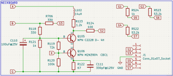

Measuring BCE of Q105 and Q106 with the meter
Q105.B: 8.96 VDC
Q105.C: 69.8-70 VDC
Q105.E: 8.44 VDC
Q106.B: 1 VDC
Q106.C: 8.43 VDC
Q106.E: 384.6 mVDC
During measurement, I accidentally shorted the base and collector of Q105, it produced the following on screen:
View attachment ShortQ105.BC.mp4
So Q105 is likely bad.
THe reason the screen lit up with Q105's C & B shorted, it simply dropped the CRT's cathode voltage.
It could well be that Q105 is not conducting any significant collector current, along with the bias current (which are orders of magnitude lower) one would expect a higher voltage drop across R122 is low at 0.384 V, suggesting a current of 0.384/68 =5.6mA. That will only drop a voltage of 6.7V across the 1.2k load resistor, so its not surprising the cathode voltage is too high and the picture blacked out. Though from a dynamic perspective it could also mean that the drive at the base of Q106 is inadequate.
Can you test the junctions of both transistors on the meter ?
All tests were done in circuit.
Q105 B->C: 0.573V
Q105 B->E: 0.611V
Q105 C->E: 0.699V
All other arrangements: 0L
Q106 B->C: 0.625V
Q106 B->E: 0.645V
Q106 E->C: 0.676V

During this observation, I was also probing the base of Q106, which is the output of the video circuitry. It had some strangeness, sometimes the amplitude jumped up and down, but this strangeness was independent of a picture being displayed.

I have also put this into a simulator, and this is what the behavior looks like:
Red is the current through R8 (R124 in real life).
Green is the voltage on Q106's base.
I just noticed in that sim, the 100R resistor on the collector should not connect to ground directly, you could connect about a 10pF capacitor in series with it to simulate the cathode capacitance of the CRT or just leave it out.

Unfortunately those in circuit tests are not too helpful.
The B-E and B-C junction tests look ok, not the E-C though, but really the transistors should be tested out of circuit.
I would recommend using solder wick and removing the solder from the pads from two terminals on each transistor to disconnect the leads from the pad, it works well in single sided pcb's without plated through holes, you can leave the other one terminal soldered on both.
Then redo the junction tests. You have to use the meter in both polarities for each test.
If the transistors are likely ok, what you should find is that with each B-E and each B-C junction, they should only conduct on one direction (polarity) of the meter only, and give a drop in the region of 0.6 to 0.7V and read open on the opposite polarity. And when you check from the C-E it should not conduct in either direction. Tell me what you find.

I have de-soldered the collector and emitter of both transistors. The measurements are now:
Q105 B->C: 0.577V
Q105 B->E: 0.607V
Q105 C->E: 0.650V
C->B, E->B, E->C are all 0L.
Q106 B->C: 0.623V
Q106 B->E: 0.643V
Q106 C->E: 0L
I did measure these values twice before posting the message, the values were consistent (off only by a few mV).
Q105 C->E is very odd.

I think Q105 might be defective though one aspect doesn't make a lot of sense in that collector-emitter conduction would tend to lower the collector & cathode voltage. I have had some difficulty finding its data sheet. Have you been able to find its data sheet ?
I think it is worth replacing it. You might have difficulty finding the original part, if you like you could replace it initially for a test with the MPSA42 or MPSA43 that is much easier to get. You just have to check the pinout before you fit it. So try that and we will see what happens.
I haven't found a datasheet for it either. However, there is a website (alltransistors.com) that lists some information about a 2SC2228 NPN BJT:
I have also found this listing for it, and the specs listed seem to match the ones stated by alltransistors.com:
This listing too states the same specification, and in the image the transistor is marked "C2228 D-4F" which is nearly identical to the "C2228 D- 4H" on Q105:

With that collector to emitter reading you got, it made me initially wonder if it might have been a Darlington device or had an inbuilt C-E diode but going against the latter was the direction it conducted in, but I cannot convince myself this is the case, it appears it is a single BJT, so it should not have conducted in one direction between the C & E termnals with a floating base, unless it was damaged and has some base to collector leakage.
We already know that when you accidentally shorted this transistor's C-B the screen lit up, which is expected, because the crt's cathode voltage dropped. There are really only a couple of possibilities, one is this transistor is defective, or Q106 (which is likely ok on testing) is not getting a high enough voltage drive at its base from the main board. So if you could replace it with either a BF422 or an MPSA 42/43, we could rule it in or out and get on trying to find another cause.
With the spot thing, keep the manual brightness as low as you can, turn it up while powered and testing, but turn it right down before de-powering and try not to rapidly power cycle the VDU in short intervals, might help a little for now.

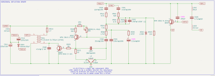

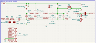

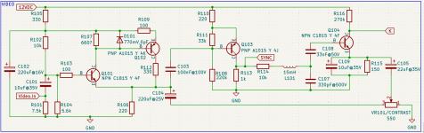

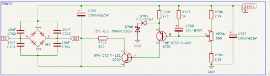

I have revised my schematic once more, this should be hopefully more accurate and easier to read.
The rails are ordered by voltage (descending) and inputs come in from the left and outputs go out to the right.
There are some exceptions to the I/O ordering in the POWER and UNORDERED schematics:
Below are some close ups of each circuit:

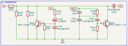

The G label on the neckboard is also not a direct connection to ground, rather it is a connection to a terminal of L103 which is then goes to ground.
It looks like a thick diode:
I am not sure about the title "G1 GENERATOR", but the circuit looks like it would produce the square wave signal I observed with the scope on G1.
Your schematics are definitely improving, but there are still some issues.
In general, all schematics (if they are going to help some repair technician at least) are drawn from left to right, in the same way that we read a sentence, but in this case it represents the flow of signal through the circuit.
So in this case (mostly) transistors are drawn in with the base connections on the left side and the collector & emitter connections on the right, from the point of view of the observer's right and left hand, if they were looking at it on a piece of paper or on a VDU. So if you reach out with your R hand it would be on the side of the diagram where the transistor's collectors and emitter are.
( just clarifying that as there are a lot of right and left mix ups in life, for example if a person is standing in front of you and you reach out with your R hand to their shoulder on the same side, you are reaching out to their left shoulder)
There are exceptions of course where there are two transistors wired as a differential pair, or a transistor in a grounded base configuration. And those transistors get flipped around sometimes to make the schematic easier to read.
Consider the flow and processing of a signal and make it from left to right on the diagram, and your schematics will improve.

I also took Q105 and Q106 fully out of circuit and measured their junctions again:
Q105 B->C 580mV
Q105 B->E 611mV
Q105 C->E 0L
Q105 C->B 0L
Q105 E->B 0L
Q105 E->C 0L
Q106 B->C 624mV
Q106 B->E 644mV
Q106 C->E 0L
Q106 C->B 0L
Q106 E->B 0L
Q106 E->C 0L
I also put the two transistors into a component tester, and both were recognized as NPN BJTs, Q105 had an hFE of around 60 and Q106 had one of around 110.
In circuit tests of resistors are meaningless, you have to lift one leg. The test only has any meaning in circuit, if the resistance reads significantly higher than the resistors stated value. In circuit other current pathways shunt the resistor so you should expect lower readings.
Your first lot of transistor measurements must have been an error for Q105, now on the tests it looks ok.
We cannot help you if your test data is defective and unreliable, it just leads everyone up the garden path.
