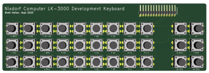

I realised that I don't need to wait for my breakout cartridge (just shipped from PCBway, probably another two weeks to get here) ... I can just remove the cartridge connector and stick a pin header on it which I can then connect to an Arduino for testing. This means the keyboard isn't easy to use so I also designed a simple replacement keyboard using Gateron low-profile KS-33 switches ... just for development outside the case.
I replaced all the capacitors - I see that they use either a tantalum or an electrolytic (1µF) on the keyboard interface board - I replaced everything with MLCCs, except for the 22µF axial near the power supply which I replaced with same. Hoping that might improve the reliability as it started misbehaving last night after some time on.
Whipped up a simple Arduino program to strobe the keyboard and report key presses - will test tomorrow! The first new software written for the LK-3000 in 40 years?? :)
All the updates on my Github.

Hey, no problem! I was going to ask if you wanted me to send you one - my little channel is sponsored by PCBWAY so they give me free boards. I don't have them yet, takes about two weeks to arrive.
I'm going to get a 12mm tactile "development" keyboard made ... thought it might be easier than using the original - can send you one of those if you like? Although, it's a bit bigger so probably won't pass as a "letter" :)
BTW, good work on finding the Popular Electronics article - didn't realise it was about hacking it. Very interesting. And from there I found that someone has developed a technique to dump the 3870 CPU ROM contents ... something on the "to do" list so this little machine's history is properly documented/archived.
