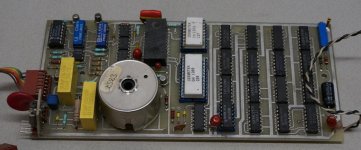

There is a motherboard having 3* 2716 eproms and a 8085 cpu.
It has some optical card reader (which was disconnected when I opened it.)
There are also 2 pins missing of the connector for this optical reader.
It -had- some nicad batteries in it which I've removed. It caused some oxidation
resulting in a not working processor board. It displayed all zero's.

On top of the CPU board is a PCB which I can remove. This doen't seem to
change the key functions. This board has also an extra small connector.
So it might be an interfacing board... And on the bottom of the thing is also
an extra cable output. But no extra cable. This might be removed once...

I can't say much about this thing. The small board with the Cermetek ICs is certainly a modem--but the interesting thing is the IC with the labeling buffed off--almost certainly an anti-piracy measure. About all I can say is that it appears to be a terminal of some sort, could be part of a security system. The EPROM content may lend better identification.
Hello all,
Thanks for the suggestions. It did also cross my mind about the top PCB being a modem.
But that was because of the somewhat high voltage capacitors and the metal toroidal transformer.
The wiped chip is a very thick one like an RTC with batteries in it... So maybe it is one.
