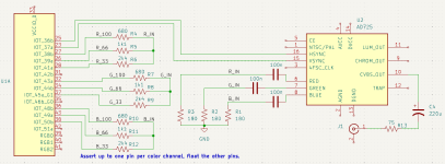

Unless your chosen FPGA is IO constrained, you can keep the digital and composite outputs separate. I sketched out a possible interface to the AD724 below. You can add a 4th resistor to the green channel (1.7k) if you want to get brown instead of dim yellow.

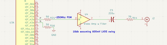

I sketched out a PDM output as well. The main advantage is that it is completely gateware defined. If you want to improve the colors, implement an "old" vs "new" CGA card or create a custom interlacing scheme to set your TV on fire, you don't need a different board.
Why do you have three pins per channel? A six bit DAC (two bits per color) can produce the “CGA palette” as defined by EGA and later (which, granted, is controversial for being *not quite* accurate to the internal brown fix on the 5153… but many CGA monitors differed on the exact shade they produced as well) by knocking down the green in “dark yellow” to the lower intensity bit. See the table here:
… anyway, that said, if you have the resources of an FPGA it seems like a waste to *not* just do PWM on a pin. To be completely blunt “quality” just isn’t as much of a concern for composite video as you might think. A simple output transistor with a filter capacitor will be just about as good as any real 80’s home computer.
Again, I think the main problem I have with using the AD724 in this particular case is it would do a good job rendering a composite view of the RGBI picture/palette, that is *not* what you get on CGA from the RGB port. (The aim of my CGA to 724 dingus was to interface a Tandy 1000 to a Commodore 1702, IE, specifically get the RGBI palette over composite/svideo.)…
Is that why there’s nine (or ten?) resistors, so the FPGA can be programmed to preprocess the output to use any of the RGB, “official composite”, or “artifact composite” palettes? (Although if that were the case wouldn’t it be more straightforward to wire them as a 9-bit or 12 bit DAC instead of just getting three/four discrete values because you’re picking one and floating the others?)
It's mainly to allow adjustment of the colors somewhat independently, especially brown/yellow. That circuit can be run in a 2 bit dac mode, or PWM as you mention. I'm not sure about using PWM with that encoder without filtering first, there may be issues with the RGB/YUV frontend.
