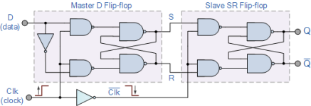

What we have in the original system is:
A shift register- I understand this takes the serial data from the VB mainboard and sends it out parallel. My best guess is that it's a D-Flip-Flop + SR Flip-Flop configuration, because I've read that a D flip-flop takes in data with a CLK signal, and an SR flip-flop takes in data with an ENABLE signal, which the VB mainboard provides both of.

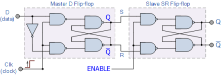

My best guess is that the configuration is like this:
A latch- The SR flip-flop portion of the register element. This is what "captures" the data bit needed for the pixel, through what is basically a feedback loop.
A gated LED system- This is described in detail in the original VB patent, and I do understand the logic gates. Furrtek also helped with his posted research: https://furrtek.org/?a=vbtvout
With all available info, my best guess is that there are TWO shift register elements + latches to drive the LED data lines, as there is a D0 and D1 data line described on the patent, and there are _0 and _1 data lines (8 each) coming from the VB's display board.
(If anything, It's probably better that I'm going the original-logic route, because I would have to use double the shift register ICs [14!] if I had gone the off-the-shelf-route)
Despite already have a basic schematic started, the shift register and latch is where I'm getting stuck.
The ENABLE can also be fed into the front-end with a 3-input NAND gate (as per your schematic.
It also depends upon what is meant by 'enable'. Does it mean that you shift the bits in serially then 'enable' the bits that have been shifted in to be presented to the outputs in parallel?
If it was me, I would try to get some traces of the logic signals (from someone with a real system) using a logic analyser.

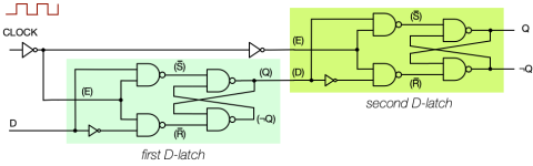

In my studies, the closest circuit I could find was the dual D-flip-flop, thanks to this document from the University of Vermont: https://www.uvm.edu/~cbcafier/cs2210/content/04_logic_gates/latch_and_flip_flop.html
The dual flip-flop shown in the document is configured as a flip-flop (1st) & latch (2nd).
The first D-flip-flop acts as the input, the second as the memory.
The reason why I think it's this is because Furrtek describes an "automatic" latching of the data, which is impossible without an edge signal to activate the gates.
The way I see it, the method of inputting the data is this (for one data line):
  • The "first D-latch" in the diagram is chained in a shift register configuration. (I will call this "First-Stage" or "Stage One")
  • The "second D-latch" in the diagram is a collection of individual circuits connected to the Q of sequential registers. (I will call this "Second-Stage" or "Stage Two")
  • The rising edge of the CLOCK "opens" the Stage One registers, and brings in one bit from the data line to the first register.
  • The falling edge of the CLOCK "closes" Stage 1, and "opens" Stage 2. The bit is passed to the latch.
  • The rising edge of the CLOCK opens Stage 1, and shifts the bit forward to the next register. The next bit is brought in.
  • The falling edge of the CLOCK closes Stage 1, and opens Stage 2. The two bits are passed to their respective latches.
  • The rising edge of the CLOCK opens Stage 1, and shifts all bits forward. The final 224th bit is brought in.
  • The falling edge of the CLOCK closes Stage 1, and all 224 bits are now passed to the latches.
