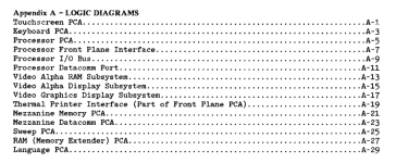

I bought a non functioning HP-150 off facebook market place. I'm going through the process of trying to get it running again but i'm struggling to find the schematic for the computers power supply.
Bitsavers has its technical reference manual which seems to have every other schematic but the power supply for some reason.

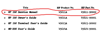

The document does reference some other documents. Which I think I need the "HP150 Service Manual" "45611A" "45611-90002". But ive been struggling to find that document unfortunately. I don't know if any of yall know where it could be found?

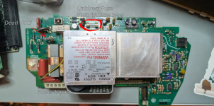

What I know is wrong with it at the moment:
1. The main externally accessible mains fuse is blown. Looks like it had some energy behind it.
2. The main power board has a component with a chunk missing out of it. I assume its a NTC inrush limiting thermistor. Don't let the photo angle fool you it only has 2 legs. It has another of the same part next to it both are labeled TH100, TH101. The components are next to a transformer, 4 diodes, and I traced one legs of the blown one to go to the biggest capacitors on the board. Unfortunately I found the blown chunk at the very bottom of the PC so it would have had a chance to short every single logic board on its way down if I'm unlucky. There are no markings on the component itself for some reason.....
Either way based on my reading of these components if I have identified it correctly im wondering if what happened was the computer was turned off and back on fairly quickly. The NTC might have been pre heated meaning it wouldn't have blocked the inrush on the big old caps. Causing even more heating in the thermistor cracking it while also blowing the fuse. Although this could also be caused by any number of component failing causing a short.
There is another fuse on the power PCB that isn't blown. It looks downstream. But at the moment I havn't traced out what it controls. Praying one of yall has a schematic so I don't have to 😅.
Nothing else on the board seems to have visible damage but I havn't checked any components yet.
3. Otherwise I didn't see any visible damage on other components other then the main board and the daughter board attached to it mounted poorly.

I hit post too soon because I found the HP Computer Museum website has some great documentation on it.
Although there still isn't a official schematic for the power supply weirdly? Just a hand drawn schematic labeled "SchematicsByTonyDuell".
God bless you Tony. Through some rudimentary research it seems like the guy does alot of reverse engineering of HP computers.
Still don't know a Part number for the thermistors but it confirms my wiring theory
There is a good chance you have blown (shorted) rectifier diodes. Had something similar happen to a totally different power supply recently.
Edit: looking closer at that schematic, I see your thermistors are AFTER your rectifier, where mine were before. So could be something else going on there.

C105 right after the rectifier turned out to be the issue. I don't think it was fully shorted at first but it definitely became fully shorted. I replaced C104 alongside it while I was in there.
Ordered the wrong NTCs on digikey which added a lot of waiting time. My fault for not checking the lead diameter of the ones I was replacing....
