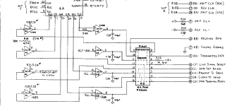

Powered up with boards disconnected, and everything nominal, onto board and it seems to boot but nothing on my terminal.
Looking at the N* manual, the jumper to set the serial port seems to expect a modem and a null modem cable doesn't work which I suppose is expected but the standard connections of DTR/DSR/CTS/RTS less so.
For some reason the standard header seems to wire DTR into pin 5 which would normally be CTS and DSR is connected to RTS, RTS connected to DSR and CTS to DTR ! Bit spaghetti like. So to remain compatible with the plug and lead I use on my EPROM programmer I have rewired the header thus
So CTR/RTS connected together, Txd and Rxd not swapped so my null modem cable works and flow control via DTR/DSR.

Still no joy so I have installed the PROM option detailed here https://deramp.com/downloads/north_star/hardware/ZPB-A PROM Mod.pdf, EPROM with the Diag rom from here https://github.com/codesleuth7/northstar_horizon_z80_rom and now it boots to
E000
but only for about 5 minutes, after that, corrupt data then nothing. Seems to be temperature related. Swapped the USARTS around but no change (and I did note that the end pins on one of the USARTS were bent and it wasn't me !, almost looks as if someone has been investigating the same issue before).
Seems to be a problem addressing the USART so first port of call, check the buffers on the PCU card to the bus. Pulled the first 74LS241 out to find pin 1 missing and I don't mean it was left in the socket but actually missing. Seems the pin has been snapped before and just pushed back harder into its socket. The pins are also very black due to the silver oxidisation. New leg soldered on but no better.
Pulled all the other 74LS241's and on every single one, pin 1 is cracked and most are near dropping off. A known issue with some Ti chips apparently and certainly every 241 needs replacing on this board. However with a bit of a clean and careful reinsertion, the machine now resets to the diag rom prompt and pressing B starts a boot and gives me
