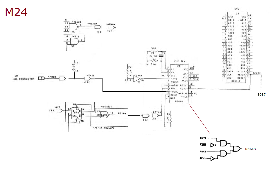

I have a PC1050 with 5V, 12V, and -12V connected to a bench supply and I was wondering if there was supposed to be a beep if it runs/comnpletes some of its POST.
I get around 3 Amps on the 5V rail and practically nothing on the 12V rails.
I needed to tie the READY line high at the 8087 to get the 8086 to execute instructions. Seems that they should've had a pull-up on this signal...
I can see lots of bus cycles at the 8086 and the EPROMs, but I dont have anything other than this motherboard so I cant tell if it is executing normally or not.
Is it supposed to beep at any point in the boot/POST code? Or do I need more stuff hooked up before it progresses to a point where it beeps?

According to an M24 circuit diagram that I see online, READY is generated by an 8284A chip, and that 8284A asserts/de-asserts READY based on the state of many other motherboard chips. And so one possibility that READY is LOW is faulty circuitry somewhere on the motherboard. A partial diagram is at [here].

To follow up, I do see activity at the parallel port outputs so I am satisfied that the CPU is successfully running some of its POST.
I am investigating a very similar issue with my recently acquired M24 motherboard. The /AEN1 is constantly high and the CPU/NPU READY is therefore constantly low. Today I powered this motherboard for the first time, and I am also dealing with M24 motherboard for the first time. /AEN1 is ~AEN84 in the Olivetti schematics and controls the wait states to the CPU. That I traced, so far, to ORDY signal being low. Obviously my problem is off motherboard, e.g. either on the videocard, or on the backplane. This differs from MicroCoreLabs's case since they don't have any cards attached to their motherboard and the ORDY is pulled high via R51 on the motherboard.
