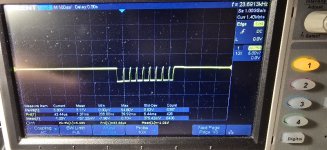

Tried to measure clock and data on the "good" keyboard.
Data:
Clock I was unable to capture but I noticed this on the NC:
Not entirely sure what this is, probably picking up noise from the clock line. Since the keyboard works fine I took it as a baseline.
When I tried the second ANK1924 on the same PC it just worked. I thought it had to do with the disconnected ground but I could not reproduce it.

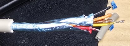

That left the repair styles that I used.
If you compare the repair style I used you can see this:
Keyboard 1:
Keyboard 2:
My conclusion is that method one is more solid. Although I should have used longer heat shrink tubing and close the end. Probably it broke or disconnected when I wrapped eveything up. So no difference after all. Will redo 2nd keyboard properly and wrap it up. Then I will ship it.
