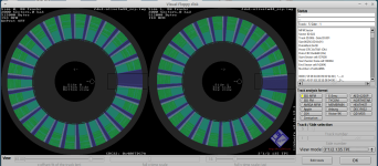

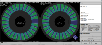

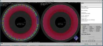

Here is what the HxC Software displays:
See attached PNG files.
