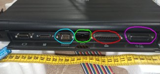

On that, i have some questions if anyone knows, i first started on the wrong foot by trying to use the COM port to emulate a ps/2 keyboard, but after finding some pictures of the official HP dock and some research, i think the dock is working as a passthrough for the PS/2 keyboard and using the proprietary port on the right (circled purple).
Meaning i probably should plug into that if i want to brute force via ps/2 inputs.
Would anyone have documented that port/the dock connections so i could get some informations on it? I need to find my multimeter :/
I can totally just plug in the DUpont cables into the pins, its just gonna be impossible to guess i think
Other option is to go through the physical keyboard interface, but same issue, im not sure what those flexible cables are at this point. Any idea what they are and how they are called?
The ports you have circled are as follows:
BLUE - 9-pin Serial Port
GREEN - Infrared (IR) communications
RED - 25-pin Parallel Port (8-bit parallel data, unidirectional/bidirectional, commonly used with printers)
PINK - SCSI+Docking Port
It should be relatively easy to use a multimeter to determine which of the pins carries power and ground. The metal shell of the connector is also usually tied to ground.
In between the two serial ports you have an external floppy drive connector and there is also a special SCSI cable for this machine that connects to the dock port on one side and a SCSI-2 device on the other.
Supposedly the dock supports ISA/PCI cards, but that doesn't mean all the necessary signsls are directly exposed without multiplexing or other interface considerations.
Thanks! Having the name spared me some research. And yes i kinda analysed every single pin (80 pins), voltage, resistance and frequency on boot for the ones with no idle voltage output. Two of them had specific frequencies i mesured at 9000Hz on boot with the Pi (10k pprobably with better tools).
Also i couldnt tell if the pins i was after (DATA and CLOCK) were suppose to mesure at 5V or not, its confusing cuz they are pins in a scsi port, and havnt tried mesuring the frequency on boot on those (cuz the Pi without a setup cant handle 5V on GPIO)
From there i tried plenty of possible inputs, with python and C (on the two 10K Hz pins, also tried to reverse them ). But to no result, i couldnt manage to type anything.
It seems something is blocking me from typing with the Pi, maybe the need for the dock to bbe plugged in to allow the ps2 pin to even work (the dock has an eeprom ship etc)
Would anyone have some knowledge on what i could have done wrong to not be able to do that?
Or, have some advice for plugging the Pi to the physical omnibook keyboard flat connectors? I found that i can get some adaptor like " FPC FFC breakout board 0.5mm" to expose the pins.
Would i have any chance trying that?
This is just speculation, but since there are just eighty pins there may be a specific way to signal that you have connected a Dock vs a SCSI-2 device.
I do not know whether the PS/2 port signals (or those for any of the other ports) are directly exposed on the connector or if there is some additional interface circuitry (inside the dock) that is involved.
As for the internal flat (cable? ribbon?) connectors, it could be as simple as row, column connections to the keyboard matrix.

HP F1177A Omnibook 800CT 800CS Port Replicator Docking System SCSI
This looks like the dock in question, rather pricy at over $300, but the HP part/product number might be useful for a saved search.
Apparently the laptop is F1175A and there is also an external CD-ROM drive (F1197A)
Yeah, quite pricy.
Thank you very much for your answer! The dock seems to just use the SCSI port, so everything goes through it (that is on the back of the dock). No kidding i found so many 5V, GND pins and so many different Hz on each.
I'm thinking that yes there is one of these pins that is just a "dock connected" pin but i wouldnt know how it works or how to identify it so the task might be too difficult for me. Looking at the dock, i cant see another way that the dock would tell the Omnibook that it's plugged in, there isnt much appart from the SCSI and power interface.

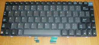

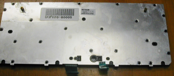

I opened the keyboard to note what the flex cables are, i got a small 9pin and a larger 16 pins (that mesure 170mm from copper trace to copper trace). Would that thing be adequate? "FPC ZIF breakout board 16 pin 1mm pitch"
Just a bit confused because of the 9pin one, why is it sepparated? the keyboard doesnt have any LED or anything. It could be an obstacle for me in that project if it's what drives the ENTER key.
I attached some screenshot of a keyboard on ebay, its specificaly this exact one.

There are ~85 keys on the keyboard pictured.
16x9 = 90 + 54 = 144
16x8 = 80 + 48 = 128
16x7 = 70 + 42 = 112
16x6 = 60 + 36 = 96
16x5 = 50 + 30 = 80 ?!
Since there aren't anywhere near 100+ physical keys, the keyboard may not be quite as simple as a square/rectangular grid of just M x N (16 x 9 ?) keyswitches.
However, there could be separate power and ground traces. And at least one of them is likely providing the Power On signal (Fn + On/Off) to the laptop power circuitry.
Moreover, there are additional Fn+Fx functions and also an Fn keyboard.
I suspect the 16 pin connector drives/selects separate groups of keys, while the 9 pin connector is where the communications happen.
You might be able to work some things out by using the multimeter to measure resistance and seeing if the reading changes when a key is held down.
May put a probe on one of the 16 lines and the other on one of the 9 and press each key on the keyboard?
If there are obvious screws/latches/fasteners then you can try disassembling the keyboard.
I can't imagine that they would have put a dedicated microcontroller in there, but there might be resistors, diodes, and potentially some logic gates.
Thanks for the insight, that might come really usefull! And as expected it might also be quite a pain hahaha, i have a simple multimeter yeah, i can try and mesure resitance but as a noobie in electronics im sure it wont be than simple to understand what's going on between the pins and keys. Will try my best to figure it out, im waiting on delivery of some pin adaptor and will get onto that once i have them and some time on my hand.
I'll have to open up the keyboard i think (and yes there is obvious screws) and have a look. If it works as u suspect (and bravo on the analysis i think it makes a lot of sense), i imagine its gonna be real tough to figure out the layout for me but i'll try my best. If its a matter of a bunch of mesuring, it might be manageable.
