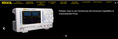

I'm thinking of buying the below Rigol oscilloscope and would like some input pro or con. Uses will be for various electronics repair which I've accumulated over time and require waveform analysis, etc. The price seems about right at $279.00.
Rigol makes a bunch of very similar models, what exact model are you thinking of?
I have a low-end Siglent, which is basically the main competition to Rigol, and I’m pretty happy with it, but I do kind of regret getting a two channel one instead of four channel, which it looks like you’re considering.

Do you know how many channels you need? How much bandwidth? Sample rate? These are the big factors in determining which model and what price.

Rigol DS1102Z-E
I think the 4 channel would be an overkill for just P/S and simple waveform troubleshooting. Won't be dealing with any timing circuits Pulse in/out, levels etc.

That looks really similar to my Siglent 1202X other than bandwidth (100mhz vs 200mhz), for simple tasks it should do just fine. The only reason I find myself wishing for more channels is I've been working on projects where signal X is the result of the convergence of events with signals Y and Z at it would be nice if I could get full traces on all of them, but generally I can compensate by using the external trigger on one of the variables and moving the probes accordingly.

So I think I'll go with it, all the reviews seem positive.

If you only need / want 2 channels, I'd take a good comparison look at the newer Rigol DHO802 or Siglent SDS802X HD models for not too much more in price.
The Rigol DS1102Z-E is probably a bit dated in comparison.
