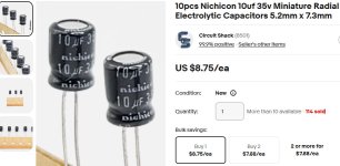

Can you share what part number you ordered for the 100 new 10uF but 35vdc caps?
Sorry cannot at the moment.
reason is my term 'Ordered' was not mean in the literal sense. I rang and got an associate of mine, to get his ISO9001's certified Companies Purchasing officer to research a range of suppliers for me, to see see whom has stock of Tantalum's and what their manufacturing dates are. Many component outlets, especially smaller ones, have NOS stock that has questionable manufacturing dates. I want fresh, as in last 5 years, made components and not if possible Chinese or like.
I have not kept up with what the state of 'leaded' general purpose electronic components manufacturing is, as compared to Surface Mounted manufacturing, so hence my hand balling it to that PO.
Once I get an answer I will post here
Personally, given you can get up to 10uF in Monolithic, I tend to go with monolithic where I can for longevity and lack of long-term issues.
Monolithics are superior in almost every way as DC filter capacitors.
The ONLY time when you don't want that is when you need the characteristics of an electrolytic, eg, higher ESR or larger than 10uF.
The downsides to using monolithic are pretty minor... Minimal loss due to DC bias. Though by 25v, it does creep up, but is it actually 25v continual bias or 12v with a 25v rating?
As a replacement for a tantalum, at least you know it's not going to install any blowtorches in your circuit. Why install an electrolytic over a monolithic is the key question I'd ask?
OK, per cj7hawk, maybe I should look for a monolithic. Not sure if these are monolithicor not. I did not see a filter for monolithic.
Theses are from DigiKey. I don't know if the computer will care of the quality or difference between these.
Yep, the cheap kits are awesome... You'll get quite a few spares, though if you don't make anything it's a lifetime supply.
The 10uF should be sufficient. If it's a 12v circuit, you should get around 7uF with the DC bias, but the lower ESR makes them very effective at decoupling.
You can't use monolithic everywhere a different capacitor was used, but they are quite effective for replacing 10uF Tantalums for that purpose.
