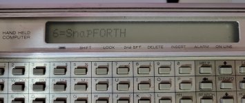

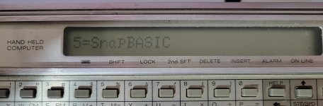

So the plan is:
Install PicoRom inside the program storage module. This will require some simple modification since the PicoRom is 32 pin and the sockets are 28 pin. Nothing major. I will install a USB C panel mount to the box so that I can keep it closed. The long tray meant for the handheld and printer holds both devices. But the box does get in the way of the keyboard a bit.
Now.... the SnapForth and SnapBasic ROMS are needed for development of programs. Doing development ON the HHC is a bit cumbersome. But.... the Panasonic HHC is a 6502 based system. This means porting over the compilers to another 6502 based system should be simpler than scratch development. The original cross development kit was for the Apple II systems which makes sense. This could then be run in an emulator on a PC.
Assembly would of course just be the usual. However, some work needs to be put in to create the libraries for the hardware. This allows making use of the OS routines for driving hardware. Some is documented, but the disassembly will provide the rest.
