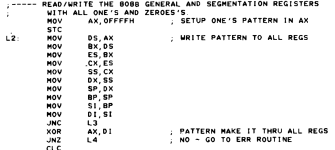

It's similar to the 8088 register tests where they chain the result of one access to the next and perform just one check at the end. Doesnt matter which specific register was bad.

The Tektronix 4052 microcode does this on start-up - it writes a value into register 0, then reads a value from register 0 and writes it into register 1, ..., reads the value from register 15 and compares it to what was originally written into register 0. Any discrepancy indicates a register fault, and the microcode halts (having written the pattern it wrote into a diagnostic register for the human to examine).
The POST does the same thing as the Tektronix then - a faulty register is a faulty register. It doesn't matter which register it is - because the register is inside the CPU chip and you need to replace it...
