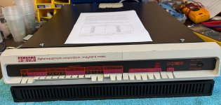

I recently rescued a PDP-11/05 in a low-profile chassis. The poor machine was exposed to extreme moisture levels, dust and other filth and was infested by millipedes and spiders. I took it home and started the journey to clean, repair and restore it.
The key was missing, so I immediately placed an order on Ebay for a replacement key for A$29.95 (about US$20.00): https://www.ebay.com/itm/324778106688
Some ham-fisted individual has been in the machine before me and broke one of the sockets on the top of the backplane. There were a few chassis bolts missing, some were the wrong length and other were completely loose.

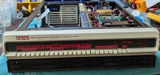

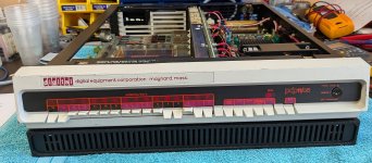

With good stable power I then started reassembly of the machine. Fitting the power supply PCB back into the power supply chassis turned into a very frustrating 2 hour struggle as the stiff cables and Mate-N-Lok connectors interfered with the two smaller electrolytic capacitors on the power supply PCB. I wrote about this and the solution in another thread: PDP-11/05 DC Regulator Module (5409728) cable routing
Briefly, the fix was using spacers to raise the transformer by about 4 – 5 mm so that the primary side Mate-N-Lok connector could be pushed underneath the edge of the transformer.
I reattached the cleaned decal to the metal front panel body using double sided 6 mm wide sticky tape. I then fitted the front panel assembly to the PDP-11/05 chassis.
With none of the PCBs plugged into the backplane I power on the system. Both Fans were blowing and all 16 the front panel LEDs were lit.
I then applied a very thin layer of Deoxit Gold to all PCB connector edges to ease insertion and removal and plugged all 6 PCBs back in. With some trepidation I powered the system on. Luckily there was no smoke or bang. I immediately checked all 3 power rails and there were at their nominal voltage and stable.
Using the front panel switches I deposited data patterns into core memory and was able using the examine switch to confirm that the correct values have been stored and that they remained stored across a power cycle. I finally entered the bootstrap loader as documented in the manual, verified that it was correctly entered and finally run and single stepped it.
It looks like the system is operational at a basic level. The only serious debugging required was the faulty Zener for the +5V rail.

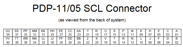

I’ll give it a shot as well. I’m not sure if having CL open is causing this (based on this no) but I was under the assumption that it was just causing the UART in to be all 1’s or 0’s. I’ll try this afternoon to make it work with what I have on hand, I should have an inverter!
I think the Retrocmp page is really great but showing the right-side-up then upside-down pinouts confuses me a lot. Firstly I take the pinouts in the table is as looking at the back of the computer panel. If it is upside down, why is the 'A B' label on the left side in the photo, wouldn't it be more logical to be placed on the right side?
Depends on whose logic you're following :-}.
Quote: "The flat cable's red #1 wire must be oriented to the left. On my 11/05, I marked this side with an "A B" label."
Thanks Paul...
I annotated Retrocmp's diagram with the four corner pins as I read the table, but if this is not correct I will delete this image so as not to further confuse things:
(Not trying to hijack Tom's fabulous resto thread)
Well, you have it upside down from: https://github.com/jaylogue/pdp-1105-console-usb-adapter/blob/master/docs/pdp-1105-scl-connector.pdf
The accompanying photo there shows the red cable mark to the right:
Which is vertically flipped from (and what you have) https://www.retrocmp.com/how-tos/in...interfacing-with-a-pdp-1105-sorting-the-wires
The accompanying there shows the red cable mark to the left:
These two descriptions *do* seem to be at variance with each other. I suspect that some of the confusion arises from whether the pin-layout of the cable-end or the panel-socket is being specified. The logic isn't at issue AFAICS. Jay seems to have the cable oriented backwards WRT the connector given that the red mark is at the right.
http://www.bitsavers.org/pdf/dec/pdp11/1105/1105_RevAH_Engineering_Drawings_Jul76.pdf, page 182, shows this (see other notes on that page!):
This is consistent with Retrocmp and NOT with your annotated photo. Retrocmp describes this as "upside down" because normally the "A" row on an IDC connector is uppermost. DEC makes a point to ensure that a THIS SIDE UP label is applied to the "B" row because of the variant orientation. The Retrocomp table therefore describes the cable-end, not the panel-socket. If you swing Jay's table 180 degrees around then it matches the panel-socket (pin "A" ends up to the lower-left); it would be less confusing if his PDF made that point!
Thanks Paul, that is a great explanation! (and now I realise I've exceeded the time limit and can't delete the photo 😦 - but, your followup definitely points out my misunderstanding - thanks again)

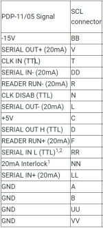

Just to clarify, the correct pin-out as see when viewed on my PDP-11/05 is Pauls first image in post #16 (https://forum.vcfed.org/index.php?threads/pdp-11-05-restoration-blog.1249299/post-1399770).
Just to reinforce the message, I repeat Paul's correct image here:
The corresponding pin-out description is here (from Joerg's website and confirmed on page C-1 of the 11/05 manual):
I have confirmed that the TTL pins listed above are working. I use pin B as GND, pin D as Serial Out (TTL) and pin RR as Serial In (TTL).
