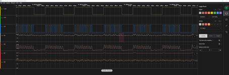

The Scope was with a 10x probe. And I started using the Saleae again because I forgot its analog measurements are still fast enough for this. It has a 2meg input resistance to ground. I have been getting lazy on my ground clips for what its worth. Not putting them on the ground of the IC I have been probing.
But I should probably start being better about it now that i'm taking actual measurements instead of eyeballing signals.
This is what I got on D6 with the E6 latch removed. Its easier to share the Saleaes captures then the ancient tektronix I got.
Load/CLR/CL1 are all digital but ive seen them analog and they look fine.
QA-QD are all analog. I don't have them all scaled the same in this image so keep that in mind.

I don't know what a Saleae is but I can say this:
The recordings acquired by many logic analyzers are a "digital reconstruction" of the signals that are there which crossed the specific assigned logic thresholds of the device being examined. Their amplitudes have little meaning and there is no guarantee that a signal seen on the display, is able to cross the logic threshold of some random gate in the circuitry on the board.
This is one reason I prefer the scope. This is because, if you know the architecture of the output stages in the logic chips you are dealing with (they are in TI's handbook), it becomes plainly obvious if something is wrong, or if that output stage is being overloaded, to this extent it pays to wear an analog cap in fault finding this sort of issue.
In the scenario you have there (/LOAD = HIGH and /CLR = HIGH - Your D4 and D5 respectively) the output from QA should be clocking at half the frequency of CL1.
QA is then fed back into the clock for the next stage (CL2). This should cause the QA output (more correctly the CL2 input) to be further divided by 2 for the QB, QC and QD outputs.
When /CLR goes LOW, the outputs QA, QB, QC and QD should all go LOW.
When /LOAD goes LOW, the outputs QA, QB, QC and QD should take up the values presented to the inputs on A, B, C and D respectively.
With E6 removed, all of the inputs (A, B, C and D) should float to a logic HIGH. This should get latched into the outputs when /LOAD goes LOW. Again, this all looks suspect...

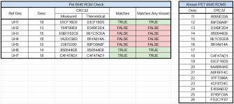

Binaries grabbed from here. If anyone is reading this while debugging their pet don't take these CRC values as Gospel calculate yourself using the binaries from the link.
The markings on the chips imply the original ROM set for regular basic. But UH2-UH5 don't seem to match what they should be or any known ROM according to my previous link. Like yall were saying to me previously. This is all out of circuit testing. Potentially the CRCs are only coming up bad because the retro chip tester is reading them at their maximum read rate. They might work in circuit. But since I'm not at the stage of debugging those circuits yet I'm just gonna order parts to make extra ROM adapters. And who knows. If UH2-UH-5 actually end up working in circuit maybe I just use my extra parts laying around as an excuse to try out some of the ROM upgrades this device could have had.
