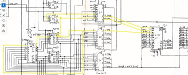

After some more probing around with the scope (a cheap Chinese handheld but should be enough for the job) I might be onto something, all of the faulty lines are linked, as per the lines in yellow below. These aren't showing normal 5v logic, they're a total mess with signals up and down in a waveform, some of them hanging around 3v.
The problems seem to start at D5 and all on flip-flop 1, I need to do some more probing around it, to be honest I really don't understand what is going on with this whole circuit and signals looping back around. All other SAn signals appear to be fine
They are probably a little noisy but these signals are good TTL level signals. If not, you would not be getting the good raster scan to create the 25 lines of 40 characters (1000 characters) you are seeing.
Flip-flop D5 and counters D6 and D7 form a 10 bit counter that is doing double duty. It is incrementing through the 1000 addresses necessary to output the video RAM data, and it is being used to help detect the proper count to increment a state sequencer to the next state. See dual flop-flop B6 at the top of the 2001 schematic sheet 3.
These two flip-flops form a 4 state sequencer that creates the vertical drive waveform along with the vertical blanking periods. Sounds simple, but look at the complicated clocking circuit! However this circuit is all working (be grateful).

You are right about signals ‘looping back around’. This circuit has caused a lot of grief to PET computer repair people.
