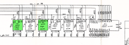

Looking at the schematic (and the H references on the ROMs may not be fully correct) H3 pin 17 is connected to +5V. So, H3 pin 17 should be connected to H3 pin 27 and H3 pin 12.

I am not sure what schematic you are using or whether you are referring to the 'H' ROM numbers on the schematic or the PCB (if they are different).
74154 pin 16 (signal /SELE) should be connected to ONE of the 'H' ROM sockets on pin 3. Which socket is this ON THE PCB, and does this align with the 'H' number on the schematic here: https://www.zimmers.net/anonftp/pub/cbm/schematics/computers/pet/2001/320132-2.gif.
74154 pin 17 (signal /SELF) should be connected to TWO of the 'H' ROM sockets on pin 3. Which sockets are these ON THE PCB, and do they align with the 'H' numbers on the schematic?
I am not sure where the 74LS21 and 74LS00 come into the equation. The /SELE and /SELF signals do go to various gates, but (for our current purpose) this is irrelevant. It becomes relevant if we are looking at why the CPU can't read correctly from the ROMs. At the moment I am just trying to ascertain whether the Kernal ROM ($F800 to $FFFF) and the PETTESTER EPROM ($E000 to $E7FF) are in the correct sockets - and whether there is an inconsistency between the 'H' numbers on the schematic and on the PCB.

Pin 3 of the roms are connected to 74LS154 on pin ..
H7 17
H6 16
H5 15
H4 18
H3 17
H2 16
H1 15
Sorry to disappoint you, but a 6540 is a 2K ROM device not a 4K device.
As you have just shown (in post #87) both H7 and H3 are connected to 74154 pin 17 (/SELF) so further address decoding is implemented by BA11.
Likewise H6 and H2, H5 and H1. The only device that isn't is H4.

Well, we still haven't fully identified which ROM socket contains the ROM for the address range $F800 to $FFFF. This is my post regarding the connection of BA11.
There also has to be an error in your post #86. 74154 pin 18 is 0V/GND and is not wired to a ROM chip select line...

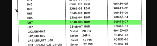

Not sure if this helps at all...
The numbering on the PET ROMs is very confusing...
So a 901439-07 in H7 and a PETTESTER in H3 is what you want.
Ignore me if this was already obvious.
