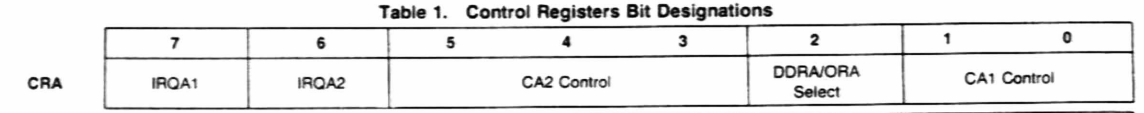

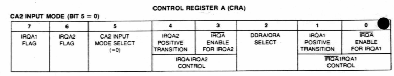

The CA1 input cannot be directly read via the PIA registers. It is not a conventional input.
The CA1 input (when initialised) sets the internal IRQA1 flag (bit 7 of Control Register A) so it can be read by the CPU. The 'edge' of CA1 (causing the setting of IRQA1) can be configured by a bit in CRA (bit 1). As a result, either a high-going or low-going edge on ATN (CA1) can trigger the setting of IRQA1.
Once IRQA1 is set, it will never clear unless the CPU takes some action (i.e. once one transition has occurred on CA1, no further transitions will be responded to).
To clear IRQA1 requires a CPU read of Peripheral Output Register A, (hence the dummy PEEK).
Sample text from the 6520 PIA datasheet (https://web.archive.org/web/2022110...ve.6502.org/datasheets/rockwell_r6520_pia.pdf):

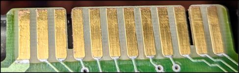

I've cleaned the connectors on the pet and in the SD2PET.

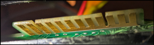

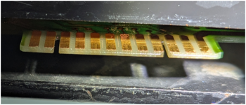

I know photos are not that helpful but....
Bottom
One of those gold fingers on the top side doesn't look fully gold, but a mixture of gold and copper.
What are the tracks like leading to the edge connector fingers on the top?
Even though there may appear to be a lot of gold on a finger, the contact area of a connector can still be extremely small.
When I developed some cards at work, I remember inserting and removing the prototype cards into/from the backplane to check the alignment of the connector / gold finger contact points by looking at the scratches in the hard gold plating.
I think it's the light in the original photo. The chassis ground is the worst but I would have thought that was not used in the SD2PET?

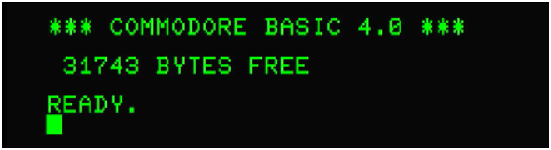

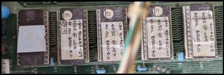

One thing I just thought of is "which version of BASIC are your running"? I suspect I know the answer to this question already, but (to just confirm) can you post a photograph of the PET start-up screen and what part numbers are on the ROMs.
The /ATN signal operation was incorrect in 'old ROM' versions of the PET. This issue was fixed with 'new ROM' versions.

One thing I just thought of is "which version of BASIC are your running"? I suspect I know the answer to this question already, but (to just confirm) can you post a photograph of the PET start-up screen and what part numbers are on the ROMs.....
It's V4 so should be OK...

The other thing to check (with the power OFF using a continuity test with your multimeter) would be for good connections from your SD2PET to the PET via the connector for all of the IEEE488 signals individually. Perhaps 'flex' the SD2PET ever so slightly (whilst taking the continuity measurement for each pin in turn) to ensure that the associated connection is not an intermittent fault.
It's hard to get the probe end into the SD2PET to do a decent test. It was made clear to me in my email exchange with TFWb that it must not be opened.
The SD2PET connector looks good and I have flexed and tried it at different insertion distances and angles. Maybe I should dig out an old edge connector and meter those out.
