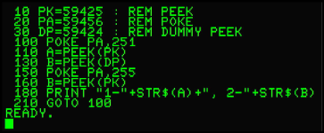

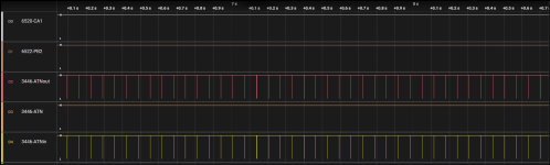

Post #20 shows a strange behaviour with the /ATN signal. This is unexpected. I would run a basic test (constantly driving /ATN out and monitoring /ATN in for errors). However, rather than using your logic analyser, use an oscilloscope on the /ATN bus pin. There should not be a 'delay' between /ATN out, the /ATN bus signal and /ATN in... You may have found the issue - but didn't follow up on it. The logic analyser 'cleans up' any rubbishy signals and presents them in digital form. It may be lying to you! An oscilloscope will indicate for real what the /ATN out and /ATN bus signals look like. Because /ATN bus is 'delayed', /ATN in and 6520-CA1 will follow suite - so the problem is from /ATN out to /ATN bus.
To ensure I have it right. The program is as follows:
The traces look good:
I connected it to the analyser and the timing looks pretty good:
Note: Only /ATN-out and /ATN-in connected.
The /ATN signal is generated by the controller to get the attention of the other devices on the bus. For example, if the PET wants to communicate with the SD2PET, it will activate (set LOW) the /ATN signal and initiate some data transfer to the SD2PET, then raise the /ATN signal high again (note this will happen part wat through the data transfer cycle). If the /ATN signal does not make it out of the PET and onto the IEEE488 bus properly, the SD2PET will never see the PET transaction. It will appear deaf...

Yes, you are right. There is (the damn dummy) PEEK missing.
Original section from the book:
620 REM TEST ATN
630 POKE 59456,251:C=PEEK(59425)
631 C1=PEEK(59424)
640 POKE 59456,255:C1=PEEK(59425)
650 MSK=128
660 A=C AND MSK
670 IF A=0 THEN GOTO 700
680 A=C1 AND MSK
685 IF A=0 THEN GOTO 705
700 PRINT "ATN IS BAD"
My revised code, with the dummy PEEK and tidied PRINT:

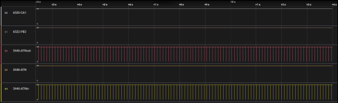

The scope is a different shape but still /ATN-out and /ATN-in are in step:
Analyser looks consistent:
