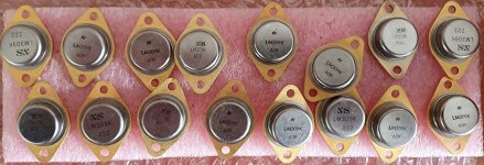

Feast your eyes on some beautiful original National LM309k 5V regulators. "They don't make em like this anymore" Truly parts of beauty.

Be aware there are now two types of TO-220 package with the metalwork, be careful buying replacements.
The original parts had a thick copper tab for attaching with a screw, it was relatively resistant to deformation by the screw, though they did manage to deform even the thick tab if a rivet was used. Any deformation degrades the thermal bond.
Unfortunately now, nearly all the TO-220 regulator parts from the major supply houses, Digikey, Mouser, RS, Newark etc etc have gone to a super thin metal tab. The manufacturers decided they could save on the copper and make it possible to use the part in a surface mount application where the user solders the tab to the pcb ! But , the thing is, if you screw these down, the tab deforms immediately, they are a disaster waiting to happen.
This started to happen a few years ago so I collected a lot of TO-220 voltage regulators. There are good ones on ebay, make sure to get the very best ones with the think copper tab. Many of the early versions made by Motorola also had Gold plated pins, and you will find they are never fakes because the fakers can never stand to part with Gold.
Never buy a TO-220 part where it is a generic image or where the photo does not allow you to see the thickness of the metal tab, a photo for these, for example, shows that they have the original thickness metal tab:
Also these, easy to see the original thickness tab, but other photos its not possible to tell.
