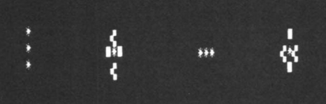

Just wanted to note some progress on resurrecting a "Game of Life" version for the original POLY-88. @abzman
There are two versions - one is a shorter version posted in early edition of DrDobbs, but the longer (570 bytes) version I found in the PolyMorphic Systems VTI manual itself (with two printed versions of that -- one "pre Monitor 4.0" and one for the final "4.0 Monitor" standard ROM). The extended version is more "interactive" (meaning you can stop/pause it, adjust pixels, then resume it).
I had to transcribe it from the manual, because the scans were rough for OCR. I did the byte-code itself. But then I did the 8080 assembly code portion, and tossed that into the AS assembler (Alfred Arnold). The only issue I had there is that the EQU statements had to start at the beginning of the line (not prefixed with tabs) - other than that, the assembler produced exactly the same object byte code (machine code) as was listed in the printing.
Now that I know it is transcribed correctly and know that it does work, I'll try it on the real hardware sometime this month.

I have the transcribed Game of Life code for the POLY-88 now available here:
(and in case any issue with github, I'll attach the pertinent files here also)
The longer version is fully tested and I deem it 100% correct (meaning, faithful to the original provided code); but still working on the later OZNAKI shorter version -- ran it once, but not entirely sure it was all correct, and the transcription was still missing comments.
