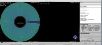

Hello,
I've dumped a Intellec 8" single sided floppy disk today and I realized that the conversion tool I usually use (HxCFloppyEmulator) is not able to decode the image.
Searching on the net, it appears that these floppies may be encoded as M2FM.
Are you aware of modern tools able to convert a flux format (SCP or other) to a more exploitable format like IMD for instance ?
I just came across what seems to do what I need https://github.com/brouhaha/fluxtoimd
It starts from KryoFlux Stream files rather than SCP, and I can easily convert my SCP to this format.
Nevertheless, in my case, it doesn't work out of the box. I have errors that I don't yet understand.
Are there other alternatives to decode raw MDS floppy images ?

Applesauce should be able to read Intel M2FM format with no issues. Unless senility is setting in, I recall reading both Intel and DEC RX02 M2FM using the device.
IMD has no notion of flux encoding beyond FM and MFM, so converting the KF stream gets you to something that's unlikely to be useful.
For me, the main purpose of creating IMD files is to provide the sector content, along with useful formating information (number of tracks, number of sector per track, interleaving etc...) and sectors in error.
Some information will be missing in the metadata if we want a true preservation format for Intellec/MDS (for instance the 'mode value' indeed only refers to FM and MFM).
But if we want to extract data from the floppy disk, like files, I have the feeling that IMD is still a good format, even for Intellec/MDS floppy disks.

Hi Gotcha
There is a difference in the encoding of MFM and M2FM. I'm not aware that cpmtools includes support for M2FM encoding - but it would have no problem with FM disks for an Intel MDS-800 or MDS Series II/III.
The initial release of CP/M was issued on a Single Density 8 inch floppy that was set up to run on the MDS-800 without modification. But that required the Single Density floppy controller in the MDS-800 (iSBC-201). The Double Density controller iSBC-202 could not read or write a single density floppy. The MDS-800 had a large number of slots and could accommodate both types of controller.
Gary Kildall had a long-standing relationship with Intel, which may relate to the choice of the MDS-800 as a platform for CP/M. In the period 1976-78, the MDS-800 offered a very capable machine - at a high price.
The early floppy disks issued by Intel had a Product ID starting with 95xxx-xxx for Single Density and 97xxx-xxx for Double Density. Later disks had a six-digit code from 100000.xxx upwards, where xxx referred to the revision number.
But, I expect the ISIS system to have its own file system and cpmtools should not help much here right ?
Correct because the directory layout is different. But, if you had some CP/M Images then cpmtools should
allow you to insert/extract the CP/M Files. But, in this case you will be extracting the files with the
isisutil-Master Perl files. It took me a while to locate them. But, they work with all *.IMD files.
So, you can convert the *.img (which are Sector Dumps or *.RAW) into *.IMD files, and extract all
of the files. Don't forget that HxC will also EXPORT lots of different types of files. It comes in VERY
HANDY at times.

In my case, I have per-track kryoflux flux .raw files. Is it supported by dskconv ? which command line option corresponds to it ?
NO, that will not work, but you can use the perl scripts from that previous utility website to process the Kryoflux files to build the file.
It all depends on how you want to do it.
Larry
The utilities to handle a series of M2FM 'raw' files (one per track) are the work of Mark Ogden. You can find his disktools at ogdenpm on github. flux2imd takes the 77 'raw' files (or a zip containing these files) and outputs an image in Dunfield's ImageDisk format. unidsk decodes the IMD file and outputs the files/data.
flux2imd builds on the earlier version by brouhaha (Eric Smith).
I managed to convert the Kryoflux raw files to an imd file thanks to this flux2imd tool available in the github repo.
I had to go under Windows for this, but I can survive :)
flux2imd.exe -f M2FM8-INTEL intellec-copie-emulateurs.zip
I have an issue with few sectors of the image, but these sectors don't contain useful data, so I should be able to extract files with the current IMD file, without to have to re-dump the floppy.
This flux2imd tool looks solid. It doesn't fail on corrupted sectors and provides a good log.
Actually, flux2imd not a script, it's a C application:
The original fluxtoimd is a Python script:
Now, I'm trying to explore the IMD image with isis.py (under Linux this time), but it unfortunately fails.
It's maybe because 2 sectors are missing in the floppy disk image. These sectors are not needed, but the tool certainly expects a totally clean image.
I'll check tonight if it works better by repairing the IMD image.
