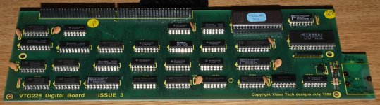

The biggest challenge here is going to be reversing the video registers, more than anything. Is the video generator a bunch of jellybean logic chips, GALs/PALs, or custom ICs? It's probably worth taking an inventory of what you can find on there.

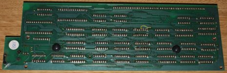

The video circuit (excluding the analogue video mixing section) appears to consist entirely of standard 74HCxx logic.

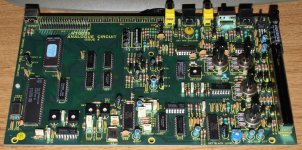

Here's some photos. There are three PCBs in the system, they connect together via pin headers.
Digital Board (This is definitely where the graphics are generated, the EPROM on this board stores the character set):
Analogue Circuit:
