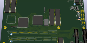

I have worked a lot on the System controller / IO decoder CPLD.
So far, I'm making some progress and the quartus project for this second large CPLD is able to fully compile now.
I am building up the PCB layout and at the same time updating quartus to match the PCB, while rechecking the compilation results.
I am doing this to be able to judge if the PCB will be able to complete in two layers which is my goal.
I am using the System controller CPLD not only for System control, CPU command generation, I/O decoding, connecting all the DMA control together and to the slot connectors, but to also buffer certain signals so that the onboard I/O will have less loading on the system bus. For example the IOW_n and IOR_n signals, I am creating those pins two times inside the System controller. One set of signals drives the system bus and the other set drives the onboard I/O. Both signal sets should work with the same timing and logic speed which will be an advantage to do it this way instead of using an external transceiver/buffer. Besides these things, I have also been able to compile the PC/AT Port B into the CPLD which controls some parity checking, reads the refresh pulse from the timer chip, and also the PC speaker logic circuits are included in the CPLD.
I have now fully connected the DMA controllers to the System controller and the slot connectors in the layout. So at least that has also been completed in only two layers now. Also a big part of the X-BUS PC/AT ICs and the IDE ports are fully connected.
I will reposition more ICs and then after I have connected the rest of the pins of the second CPLD, I will move on to designing the third. This CPLD will control the EMS paging memory system, page register programming and also provide buffered signals for the memory modules. Hopefully I can cover all the necessary signals with this third CPLD, if I can that means that the current system design would be able to be built around 3 CPLDs. I will know more later. Hopefully the third CPLD will not have trouble with compiling the remaining OE functions.
The trace density is getting very high around the 208 pin CPLDs, especially with only two layers to work with. So I will need to see if the CPLDs are able to be fully routed on the board in their current locations. With the second CPLD it is getting a little cramped, I would prefer to keep it where it is now. If that doesn't work out, I can move them further apart. However my goal on this revision is also to keep all the traces as short as possible in the core area of the system, especially all memory and DMA related signals.

I have done more work on the PCB layout, and the conclusion when I arrived at the EMS controller CPLD is that two layers doesn't seem possible. And even if it is, certain traces would become much longer than necessary. It just doesn't feel right to have to take big detours on the board with fast switching signals.
I have also evaluated the division of functions between the CPLDs. I started out with the concept to try to put as many signals into the first CPLD as possible, hoping that those functions would be possible with a single package. However when looking at the CPLD division, I decided to try a 3B revision where I have separated the address bus and data bus, and routed those through two different CPLDs. This presents a bit cramped layout near the ISA connector edge, however since I have decided to feature the PCB in four layers anyway, I wanted to also take that decision to make this new functional division. I tried to also include the memory data bus however that needs too many OE functions again because of having the two way data flow and needing to control the high and low data bus separately for the data byte conversion scenarios. When I arrive at routing the memory to the system, I will look at what the possibilities will be regarding what is able to compile in which package.
So currently I am creating the 3B layout and 3B CPLD packages, and routing the traces again. It's a lot better because I can route the traces much more directly. Also the address bus is now joined in a single package which does help the layout. I think it may also help the clock speed of the system. Still, the best solution would be a single large package, however this would also be best combined with a replacement for all the X-BUS core controller chips. If those don't need to go outside the package, that would cost a lot less pins.
I am combining the address bus control with the memory decoding, and combined the data bus control with system control and DMA connectivity. Again a few times I ran into compilation difficulty, which not only concerned the limitation in OE functions, however apparently also a limitation exists in where the OE functions are able to be routed in the CPLD. I previously had the Port B in one of the CPLDs, however when I do that, quartus quickly runs into trouble, while not close to all pins are even used. And that difficulty returned each time I added a single output. So I removed the Port B and I will feature it externally. It's I/O anyway so not so speed critical since all I/O uses four wait states anyway with higher CPU clock speeds.
So now I am on the way to building up the 3B version mainboard layout. It took a lot of work to get to this decision however it does result in a more complete impression about a better way to use these CPLDs. I will see if any further difficulties arise, though with four layers that chance is a lot less now. I will just have to spend more costs for completing this final CPLD stage of the project in a satisfactory way.

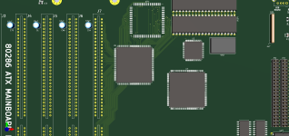

I have worked on the layout and while building up the design of the board and the CPLDs, I found more problems with quartus due to resource limitations in these CPLDs.
If I added only a single clock output, this resulted in a big fault being thrown of 226 errors. The fitter can't place the design just because of adding a single output pin.
This is adding some difficulty in the design work because I need to be able to commit to one concept and work through the board accordingly in order to finish the complete system.
And during this recent work I am always considering the list of negatives and positives in my thoughts.
This new 226-error phenomenon due to simple design changes makes me reconsider the CPLD route once more.
I believe this new problem is not related to OE functions but more to the fitter even being able to create the design inside the CPLD package.
So this is creating difficulties in the separated data and address bus concept.
Which may be able to be solved by adding more CPLD chips to the design.

In attachment the 3B layout in its current state when I start to encounter the quartus fitter problems now.
And here is the code that quartus throws:
Error (163103): Can't pack LABs
Error (163104): Can't place node "inst275~6" of type max_mcell
Error (163104): Can't place node "inst276~5" of type max_mcell
Error (163104): Can't place node "MEMW_n" of type max_io
Error (163104): Can't place node "inst270~6" of type max_mcell
Error (163104): Can't place node "MEMR_n" of type max_io
Error (163104): Can't place node "inst295~14" of type max_mcell
Error (163104): Can't place node "inst302~6" of type max_mcell
Error (163104): Can't place node "INTA_n" of type max_io
Error (163104): Can't place node "inst519~17" of type max_mcell
...... (long list)
Error (163104): Can't place node "inst324~111bal" of type max_mcell
Error (163000): Cannot find fit.
If I remove one simple output pin in the design, it compiles again.
Which I can't continue in this form because it could potentially pose some real risks of needing to update the programming and then encountering these errors again, which would prevent me from even being able to debug the whole system. That is really a big risk for the design and would be a real problem if this happens.
I will spend more time looking into using FPGAs.
Maybe the best way is to design a small custom module in four or more layers containing some modern fast RAM which has a known solution to control it in VHDL or Verilog.
Kind regards,
Rodney
