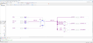

@rodney I took a closer look at your REV3 project, and offer some constructive criticism :) Some REV4 advice follows.
First, your schematics are enormous. You can make them make them significantly smaller by using bus connectivity. For example:
In the RTL viewer, you can see how the components form an array automatically:
Note that the bdf editor in Quartus can be kind of quirky...in particular, placing components directly on a bus might connect with node lines instead of bus lines, so draw bus lines explicitly to be sure.
Second, you do some naughty things with delay dependencies, clock gating, latches and async logic. You should consider refactoring the project to clean this up:
  • The low hanging fruit is to use DFFE instead of DFF registers so that you can get your clocks out of the logic. Every DFFE should be clocked directly from the global clock network(FCLOCK). Your goal is to enable the FF just before the clock edge arrives and disable it directly after. It may be helpful to run an inverted copy of FCLOCK on the other global clock network so that the enable edges straddle the clock edge precisely. There is a mechanism built into the clock networks to support this setup separately from the macrocell logic(it effectively doubles the clock under certain scenarios). Don't use the divided clocks for anything but driving external clocks or controlling the FF enables. This alone may improve REV3 timing enough to let you hit the 25Mhz you were looking for.
  • Don't use PRn and CLRn for logic. Connect every CLRn to the global clear network, and don't use PRn. I know that old mainboards did stuff like that with TTL chips. Make sure that CLRn is released synchronized to FCLOCK by keeping your clock generator disabled for a few cycles - you could use a few element shift register with it's input (and CLRns) tied to global clear and output tied to the enable of the frequency divider.
  • Consider using the Altera State Machine Editor (File->New->State Machine File) to capture some of your state machines, or even implement them in HDL. Have a look at The Fundamentals of Efficient Synthesizable Finite State Machine Design Note that one-hot encoded state machines are typically used in FPGA designs, but binary encoding is fine for CPLDs if you are low on registers.
  • Consider increasing FCLOCK. This is a more significant refactor and you will need to make sure that an edge on GCLK1 doesn't interact with an edge from GCLK2 (or vice versa) without a full clock cycle in between. 100Mhz with the inverted clock above would give you down to 5ns resolution.
  • Consider writing timing constraints files for the projects. If you at least define FCLOCK, Quartus can make better decisions about synthesis and placement. I did this for the U1 project (32Mhz) and it fails to close timing by a small margin.
With respect to REV4, anything around 20-30Mhz will work to generate the high speed internal FPGA clock. If you don't want to bother with a separate clock for OSC and the PIT, you could use 28.6363Mhz with M/N of 18/5 for 100Mhz. Digikey does stock 21.47727Mhz which would let you hit M=32 perfectly with a great range for N, but there is only one part listed (at least in the US). Running your clock to both sides of the FPGA will let you use both PLLs if you need to define more phases of the high speed clock.
Hi kevju,
Thanks for your message, I appreciate your tips and advice!
I had noticed that a lot ;) and recently I found a few more workarounds to other quirks of miss aligned placement of part connections when pasting stuff.
There seems to be some coordinate quirks going on where the parts will suddenly glitch to the adjacent spot when clicking on the mouse, it's jittery but I can work around it.
So I will remember to carefully draw the bus always outward from the component connection first and then route it on to other areas.
The block diagram is even larger in the REV4 design which will shock you ;) but I haven't had trouble to navigate it so far using zoom in/out and the hand tool is particularly fast when moving around, it must be the code of quartus that works better with that hand tool.
Eventually I will probably grow more used to the bus lines which already pop up on the HDL core AT controller parts.
It's neat to see how that works with the duplicate parts in the result, nice example!
Particularly the clock enable flipflops, I had not looked into using these yet so thanks for drawing my attention to these, this already will inspire me to think about a lot of applications, super useful!
I remember previously wanting to prevent that flipflop outputs change state and not let them clock through constantly, for which the clock enable is much more ideal where you can insert more conditions using that mechanism. I just did some searching about this which illustrated some other details, nice.
I frequently do more tests and development on the REV3D CPLDs, I will do some experiments with these clock enable parts.
I will provide the OSC externally on an input for the timing sections of the system timer HDL part.
If that turns out not to work well, I can still change the plan later.
Okay I will wire the second PLL up as well, I think I should be able to do that by moving one IRQ to a different pin.
I am prepared to expect anything when starting the REV4 testing, it may end up being an adventure which is totally okay, we will see then how to deal with that, I can adapt the approach.
Anyway a few positive things already are the large number of registers available and of course the much improved clock management.
No more running out of registers is just cool.
I just really like the idea of changing the 286 clock speed by updating the programming, I look forward to trying that out.

I'm working on the REV4 first test mainboard based on the QFP FPGA, and working out the pin distribution another time after knowing the ideal placements.
In the process I realized that on the slots we have the A20 line from the 286, however this needs to be gated for backward compatibility reasons.
However, in our system we include all the system RAM on the mainboard where we internally can apply the GATE_A20 function on the memory decoders.
So I decided to do some tests with the direct A20 line from the 286 on the LA20 line of the slots.
In principle this should not pose any issues in our pin reduced FPGA design since the lines are only used by VGA controller chips on the slots which decode whether the current cycle address is within the VGA RAM windows.
So doing some tests indeed the system initialized without any errors reported by the MR BIOS POST checks, and additionally the VGA controller functioned correctly without any glitches.

So today I have done some tests and indeed I was able to completely remove CNTL_OFF from the DEN logic, I could skip another gate in the path and the ARDYEN_n signal continues to perform the bridge function to keep the data bus enabled during conversion. Ultimately, I performed some tests on this new logic version and this has greatly improved the overall stability in windows 3.1 at 22.4 MHz clock speed.
The system has been running idle in windows 3.1 for hours and no more freezing, which is a definite improvement in overall stability, I am pretty pleased with this outcome.
I have seen the 5162 to be noted as a weird design choice by IBM, especially because of putting it in a XT case while being an AT design, however the overlooked aspect of the 5162 design there is that it is basically a continued development step in the PC/AT logic where the designers have attempted to improve the 5170 logic further. So historically, the 5162 is an important design to take note of. I still hope that some day I can have the chance to get a 5162 mainboard and do tests on this system. Even a defective specimen with the programmable chips intact, particularly the 20L8 IC, U27. This chip likely holds some cool design modifications which are so far still unknown and published nowhere. Especially there should be some modified wait state decoding present in the chip. Just to know what IBM actually programmed in this regard would be pretty cool to know more about, at least for me it would and I think there are many people who would be interested. If I ever find the chance to examine the 5162 mainboard, I will share the detailed info here in the thread. Maybe a damaged or corroded 5162 mainboard could ever be found for a reasonable price. That is also how I got my 5170 mainboard which looked a little corroded and had a very reasonable price on ebay. The mainboard also led to all the reverse engineered findings in the REV1 design, without that board it would not have been possible to determine the complete 5170 logic. The other examples of discrete chipset boards so far all turned out to be less stable and reliable than the 5170 specimen so these did not inspire me to dive into their designs as deeply as I have done with the 5170.
I will conclude the stability tests now by changing the slot LA20 line to an "ungated" version of the 286 line for further testing. I was distracted by the occasional freeze in windows 3.1 so far however this appears to have been more related to the critical DEN timing since after changing that, those issues disappeared. After confirming that the limited pin count design can make do without a separate gated A20 line on the slot, I can proceed with the design to simply use the 286 lines directly. During DMA, the 286 is in hold and the FPGA can generate the DMA page mapper output states on the LA lines instead, and during possible ISA bus master activity, the LA lines are also taken as inputs and control the memory chip select decoders. So it looks like we can keep using an additional pin for other functions like IRQ support after all. The reduced pin count FPGA test mainboard design is proceeding nicely and I hope to have this finished soon so we can order the board from JLCPCB.
