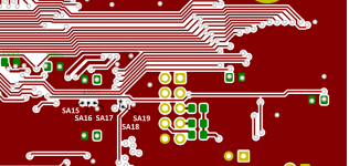

I have finished and uploaded the TOPCAT REV2 CPLD project into the GitHub.
Unfortunately I discovered a few address lines missing on the CPLD, my apologies about this.
The IO decoder here is also used as a memory address decoder which is a first case to do this, so I didn't notice this while working on the schematic unfortunately.
I have prepared a new layout and will upload it shortly after going over the surrounding ground planes etc.
For anyone who has already manufactured this board, such as Patrick has, sorry Patrick!, fortunately the lines are easy to manually wire at the bottom of the board between the slot address lines and a few unused vias which connect to a number of unused CPLD pins at the top. Starting with the TOPCAT REV2 I am now using vias to provide access to as many unused CPLD pins as possible. So these vias can help to allow easy access to solder a wire on the bottom of the board to one of the vias to connect with an unused CPLD pin if so desired. So in this case we can make use of a few of these vias. I prepared a few images, as seen from the back of the board, to indicate where the wires need to go. The vias that need to be soldered to can be gently cleared of solder mask paint by softly scraping with a small flat screwdriver or similar not so very sharp small tool. It's best to solder a piece of flatcable wire that fits between the vias and slot pins so the wires will remain neat and flush to the back of the board, and are kept in sequence which is also easier to work with. So these manually soldered connections in the pictures here match up with the uploaded quartus TOPCAT REV2 IO Decoder CPLD project and these are also the same pin numbers which are going to be used for the layout update which I will publish shortly.
For a complete test of the TOPCAT REV2, I do advise to take the effort to just solder these wires in so the option ROM feature can be included and also tested with the XT-IDE universal BIOS.
Of course, I will also order the TOPCAT REV2 board made and build it here as well, and I will also be testing and using the option ROM.

I also added the missing address lines on the TOPCAT REV2 board layout which is only a small update, and uploaded this to the GitHub.
For the TOPCAT REV2 builders I also added the relevant CPLD programming info for the IO decoder CPLD.
The quartus project is available on the GitHub page as well.
