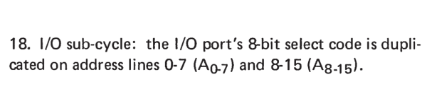

The 8080 does this differently. Although seemingly undocumented in Intel's datasheets, during an input/output port cycle the 8080 mirrors the port address on A0-A7 to A8-A15. Vintage S100 bus designs (notably, the Altair front panel) took advantage of this feature.
