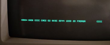

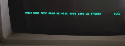

But have no luck Booting with the disks I have, Couple of Org IBM disks and a copy set TextPack 4 1to3 disks.
Have the code 02 so that tells a bad disk. Just only reads track 0.
Only with 1 disk TextPack4/1 I get a very long error code starting with 9xx ending with CCCCCCC
Yeb cleaned the heads.
So some progress.
You will have a hard time getting a non-displaywriter keyboard controller to work with the Textpack system because the keyboard contains the key map for the Textpack software, some diagnostics and also the system sound. Each keyboard has a number identifier associated with it for what language layout it has, and this is identified by the Displaywriter BIOS during POST and used by the Textpack software. The error you are getting is because the BIOS has not identified a keyboard number and Textpack has asked for what number keyboard is attached and the system replied null. I've emulated the situation you are facing by unplugging the keyboard on my unit and stepping through the POST diagnostics with the white button on the back of the unit and I got code: "*900* 00D0 CCCC C9E2 E2 003C 0044 1000 20 DADCFA CCCC" using a known good diskette of Textpack 3.
DOS and CP/M for Displaywriter do not use this Keyboard information however and you will be able to boot those programs if you have them.

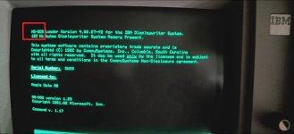

As the Software, MSDOS Boots, CE12A1 diagnostics boots, and PDD12A1 also.
All Textpacks 1 and 4 fails with the long error code. Pack For I have org IBM 8"Disks.
I'll wait till I get the keyboard working and manage to do a system check with the system setup disks.
As I now Boot that disk at top row it mentioned 128k, have 4 MEM block installed on that MEM card.Strap is in the middle
So should have more mem available I think.
As for the 8049 I will dump the software, when it arrive.
HAve to see How I can readout that software from 8049
I'll be back
It is 192kB Present as MSDos found out after Boot.
Can't find any document about these mem block, or how many each block should be.
Do I need a system setup or check to store that way the amount of mem installed?
As I have a second mem-card I populated those empty sockets as well and took out that middle strap, as
I found on picture on the internet, with full populated the straps are all out.
But no difference at that mem count.
