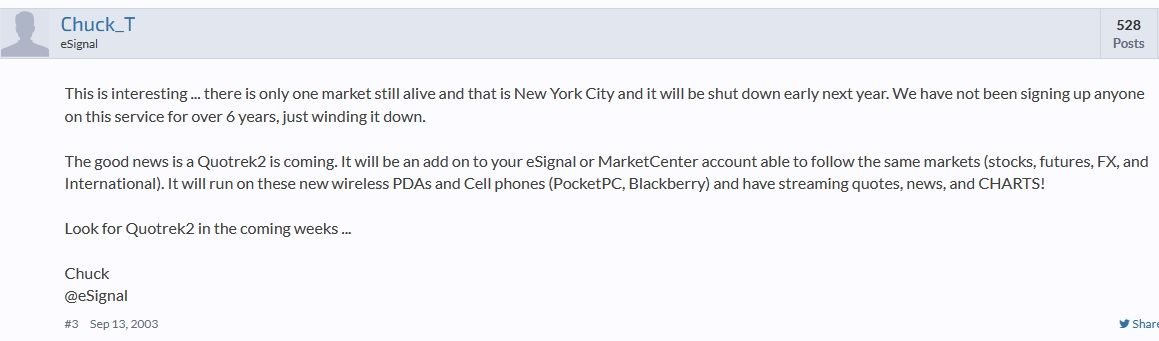

Signal, somehow continues on to this very day under the name eSignal.

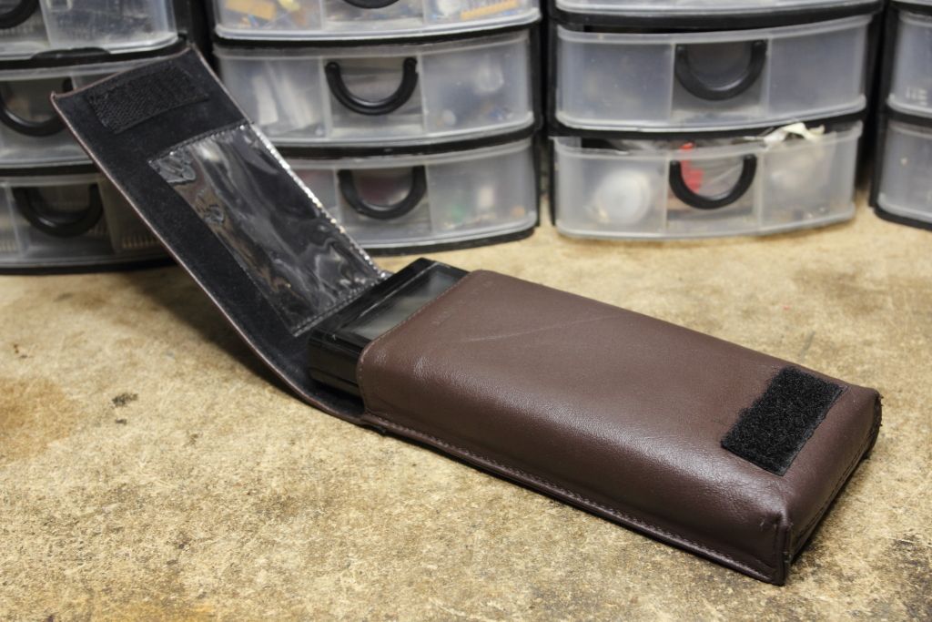

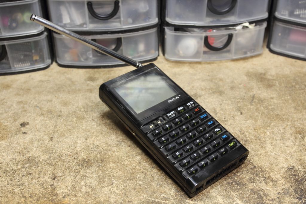

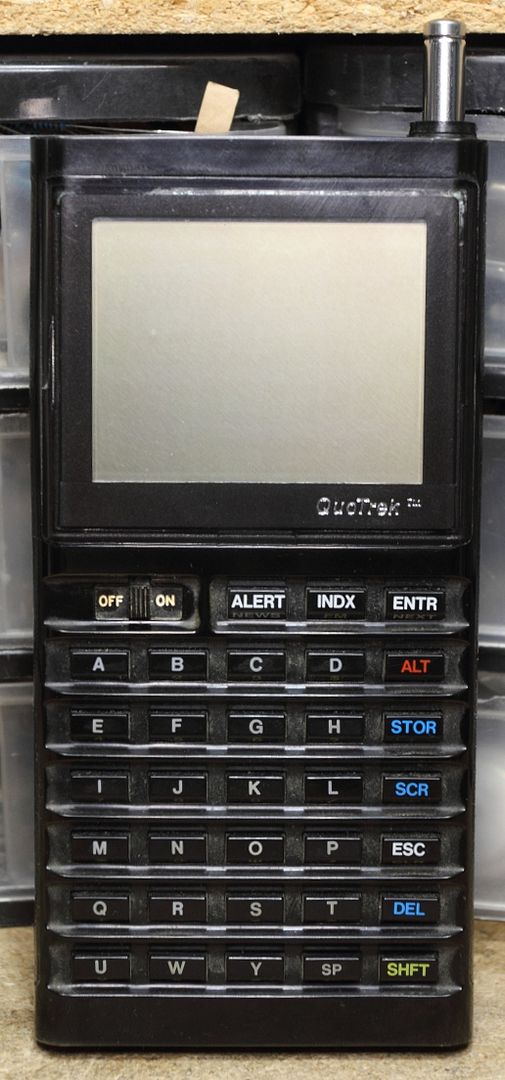

The handheld arrived in a very clean and soft simulated leather pouch that when flipped open revealed a windowed pocket for a business card and the pouch holding the handheld. The handheld while smaller than a Cybiko handheld communicator felt considerably less cheap. It was nice and weighty, the plastics had a quality feel to them and the finish felt very refined. A large non-backlit LCD screen with multi-function buttons, a very strange On/Off power switch and an extendible and surprisingly long antenna were standard.

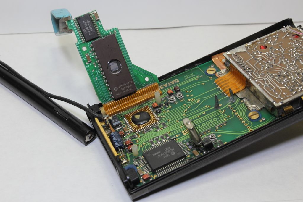

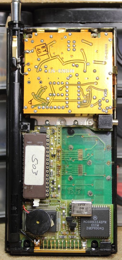

Internally it was advertised to use a rechargeable battery, to which I concerningly noticed there was no door to access the battery so I feared the worst for cells that were likely more than 30 years old. The handheld hides the four screws under the four rubber feet and the back easily separates, revealing that the battery had only begun to leak and the leakage was minimal enough to be brushed off.

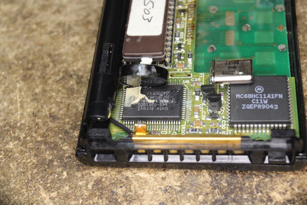

The heart of the handheld is a Motorola 68HC11 MCU. A custom chip from Oki marked “Gate Array2”, from which the piezo beeper was stuck on top handles the supporting glue and an EPROM stores the firmware and likely the device serial number. Above the void for the four half-size 1.2v gumstick batteries is the sealed and soldered RF module that is the FM receiver. Slightly below that is a 2.5mm jack, for which I am not sure what it’s used for.

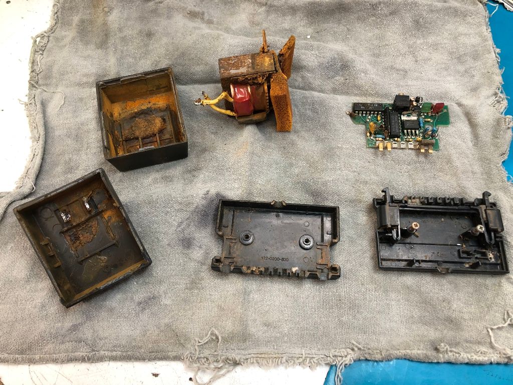

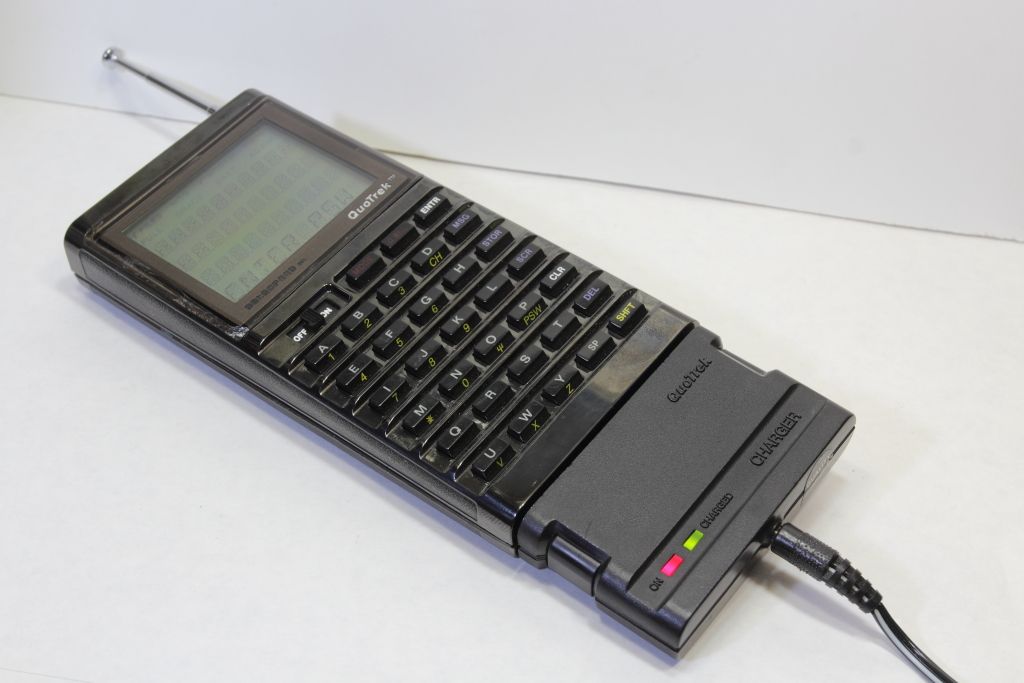

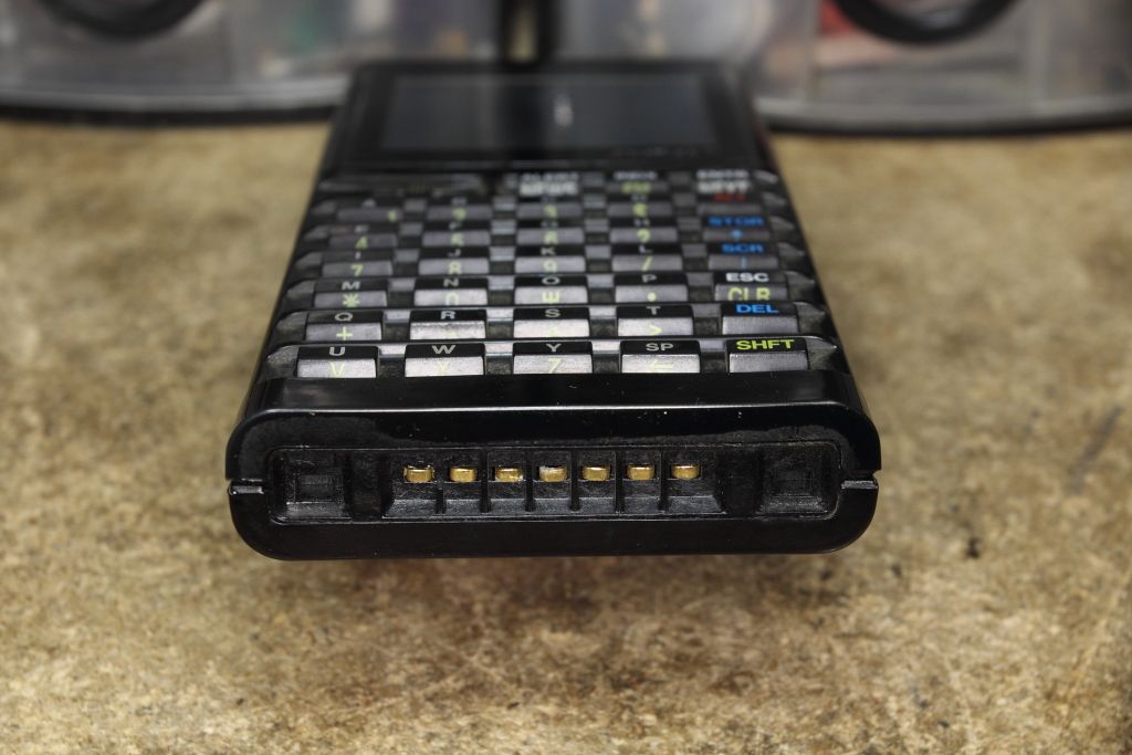

The base of the handheld has gold plated pads which would connect to accessories, such as the charger. Those would arrive shortly after from our other seller in Northern California. Immediately I noticed both the charger and adapter were quite dirty and when assembled and attached to the QuoTrek it emitted a strange 60hz buzz and the screen randomly activated with garbage. Okay something’s wrong.
As it turned out, both the adapter and the power supply had been through a flood and while from the photo the damage looks quite bad the only fatalities was a 1000uf 10v lytic capacitor inside the AC adapter which was so dead it had fallen off the board and the red charge LED in the adapter, which I replaced with a green LED. Once that was cleaned up I was getting a nice DC output with no insane ripple but the QuoTrek still would not turn on. It seems like a lot of devices this was expecting a good battery in order to work at all.

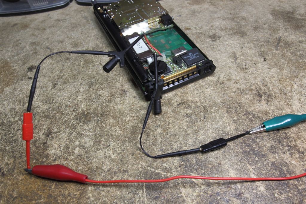

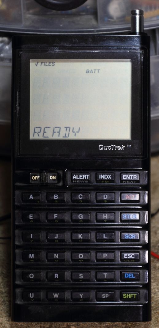

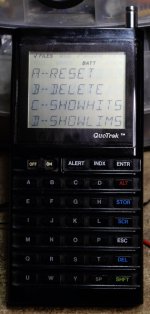

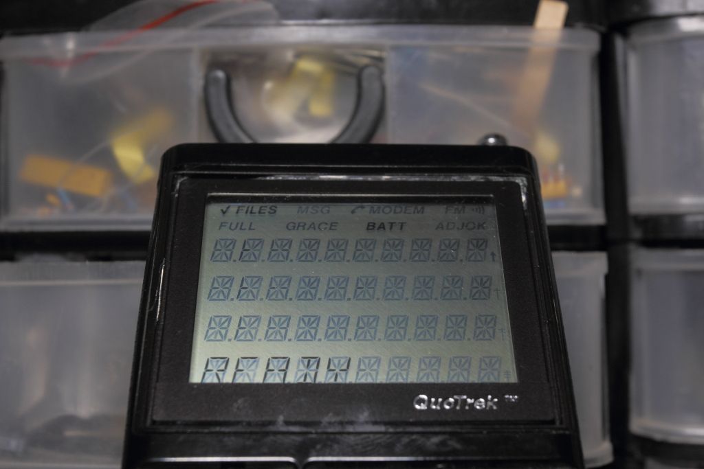

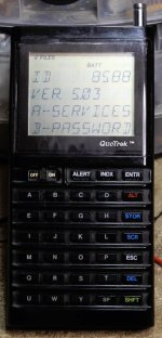

Since I wasn’t about to source new batteries yet I instead snipped the leads and attached my regulated bench supply. At 5v I slid the switch to ON and it beeped, filled the screen and then greeted me with a READY prompt.
From here however we cannot do much else beyond navigate through the various settings. With no FM signal to receive and no subscription, stock information is permanently unavailable and with the battery long perished whatever was last stored in the handheld’s memory was lost. Interestingly though with the unit now functional I could see the other various indicators hidden on the LCD and among them was what implied was a mode for use with a modem.

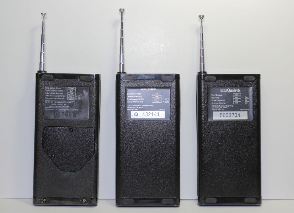

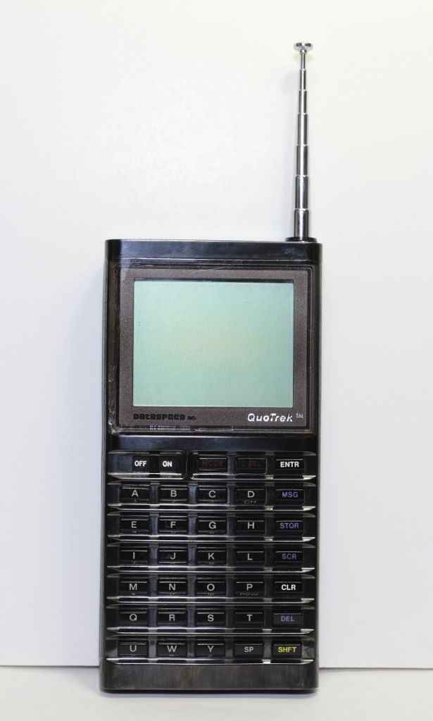

As it turns out, not long after my initial post on the Quotrek I purchased a second unit that was branded by Lotus instead of FNN. This earlier unit used a simplified pair of AAA cells for the battery and a different board layout. It used a smaller 27C64 EPROM instead of the FNN's larger 27C1001 EPROM. It also annoyingly requested a password if the battery went completely flat but thankfully the previous owner had written it down and that granted me access into the unit which lacked much of the menus and settings of the FNN unit. I have dumped both EPROMs and attached them to this post.
And then there were three.

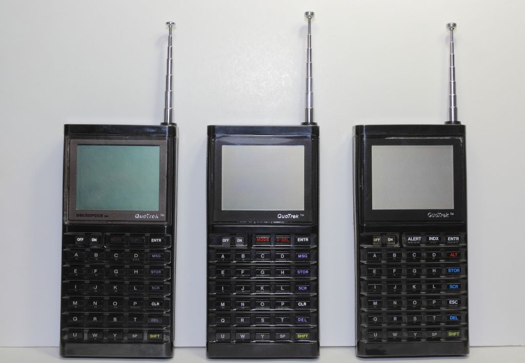

It's interesting now that we have three units how the unit changed over the course of the 80's. We can see it as it went through the ownership of no less than three different companies, each of which had their own idea of what was best suited for the customer.

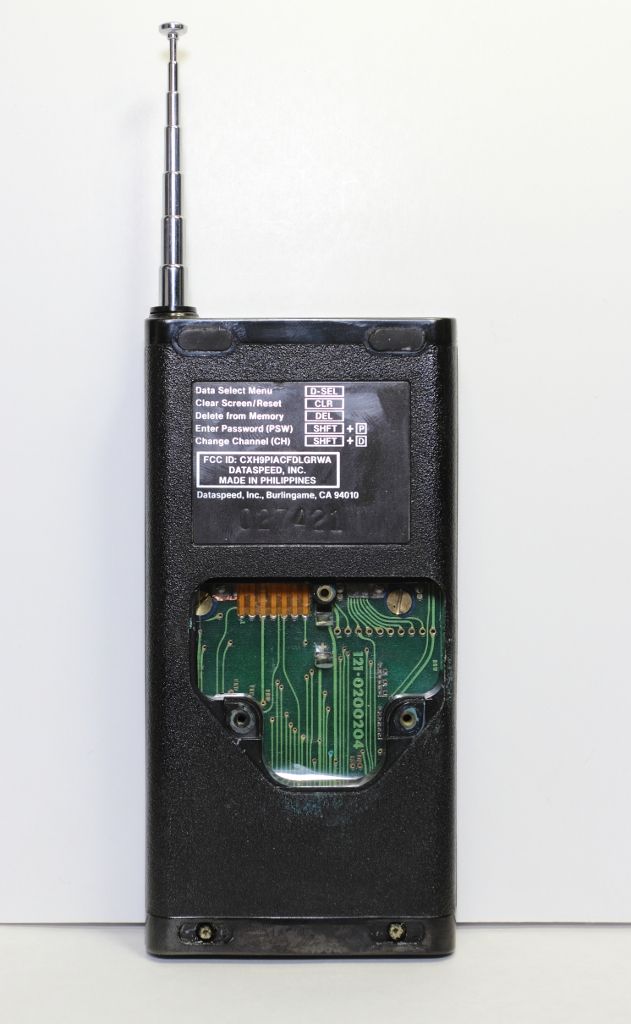

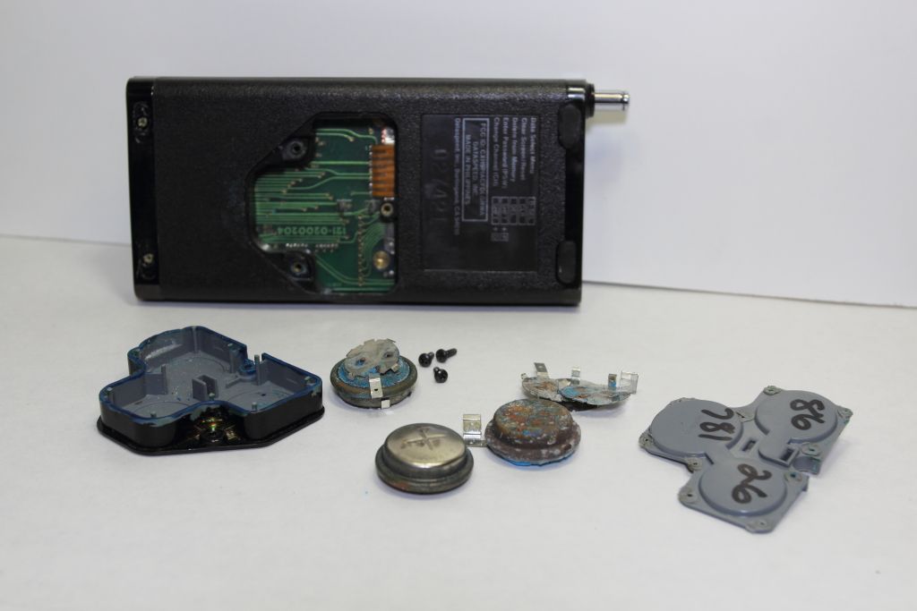

On the earliest version, we see the keypad layout has remained unchanged, but the available functions have been simplified. In addition to the later units with a non-user serviceable rechargeable battery, the original QuoTrek is powered by a removable pack, containing three very large coin cells...which of course will leak with time.
This poses its own problems in terms of damage but also give you a better opportunity to jettison the cells before they become more destructive. Interestingly in a slightly newer revision that was released by Lotus early on the battery door has been removed. The outline in the plastic remains but it is no longer a separate part with screws.
On the inside however, Lotus changed almost nothing.
Once again we find a 2764 EPROM and a custom gate array represented by an epoxy blob on a custom QFP carrier and using surface mount. Now however we begin to see the differences between the models.
Dataspeed: Hitachi HD6301V1F and a Hitachi HM6116FP-4 2kb SRAM
Lotus: Hitachi HD6303RF and a Fujitsu MB8416A-15L 2kb SRAM
Both of these units on power loss will default to prompting for a password when power is restored. What we now know is that the password is hard-coded. What makes me say that? Well remember with the Lotus we received the password written on a piece of paper. That password worked. On this one we received nothing and the instructions we get on the pocket reference guide (click here by the way to take a look at it - https://archive.org/details/QTRRG1140200300 ) is that you just set a password and off you go. Nope. Either when you received the unit it came with a password already seeded or there's additional instructions for a default password I don't yet have.
Okay, so then with a ROM where we already know the password we can disassemble that, look up the known password string, then dump the ROM for this unit and pull the string from the same location, right? Well not quite. It seems that while the ROM has the same entry point for the processor (the 6301 and 6303 are essentially the same), it immediately jumps off to the gate array and begins working in an encrypted mode! Dataspeed didn't want people snooping around and as a result the password isn't immediately obvious. I'm sure with some more constructive reverse-engineering this might be cleaned up but for now it means that getting it won't be easy.

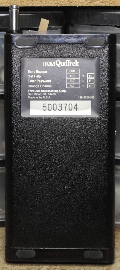

Like we already saw, it visually looks the same, however the buttons now perform more functions and as I could see by navigating through the system (which I will repeat does NOT demand a password on a loss of power) that this must use different firmware and it does. Not just a much larger 128kb EPROM but a new processor as well.
FNN: Motorola MC68HC11A1FN and a Motorola MCM60L256AF12 32kb SRAM
Even in our comparison photos, this was a major redesign of the Quotrek. New board, new firmware and new functionality, all in the same handheld that as the end-user remained unchanged. I wonder what made FNN consider it was time to spin a new set of guts. I wonder how this affected the radio receiver. What is this Modem the guide talks about? I'm sure there's more to the Quotrek that will emerge as time rolls on but I hope my series of investigations, photos and contributions to the cause are helpful to the next person to pick up the pieces and figure out more about this wonderful device.
