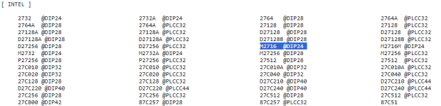

From the supported list in the XGecu site neither the T48 nor T56 directly list intel "D2716" as supported... but D is the grey ceramic package. All the data sheets point to M2716 as equivalent - this ALgorithm doesn't work for reading or writing.
you'd think reading would be ok with any 2716 profile.
right back in the thread before all the debate we'd figured out reading with a different profile was fine. i.e. AM28C16A profile. And I verified the data by mounting the chips back in the machine and booting from them, and also dumping the rom contents to the terminal as text. 40 year old chips with no window covers...
