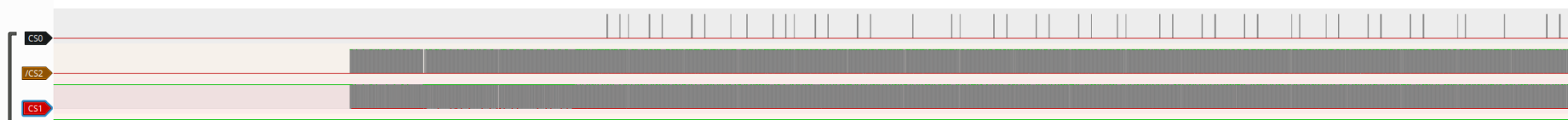

Hooked up the logic analyser and can see the PIA is being addressed.

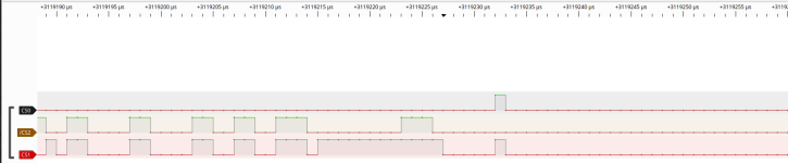

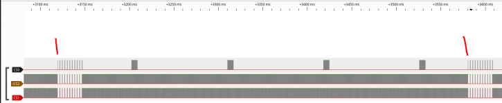

Looking at CS0, CS1, /CS2 I can see there is one small pulse (in red below) where CS0 is HIGH, CS1 HIGH, and /CS2 LOW
Zoomed into the pulse:
Hmm....requires further head scratching.

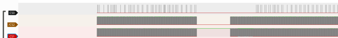

Not sure if I'm seeing that.
The long gap is during a reset.

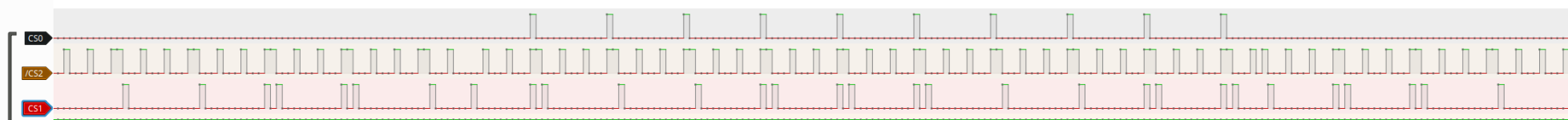

The first few pulses don't select the PIA as /CS2 is always high when CS0 is high.

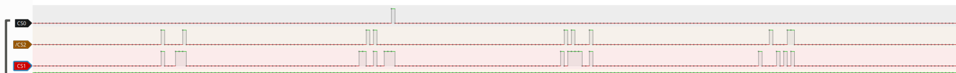

The 3rd pulse here however has the correct logic:
