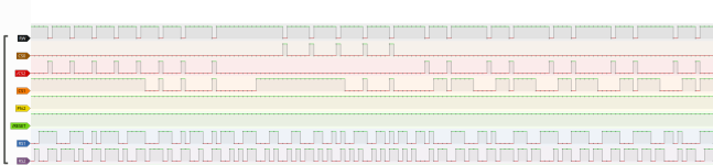

I've hooked up the control pins (With the PETTESTER)
Done a reset and captured a few seconds of data.
The PIA is selected here: CS0 HIGH, CS1 HIGH, /CS2 LOW
Zoomed in:
I'll capture the data bits, but what should these be sync to?
Leave in the control lines, RS1, RS2 and then 3 bits at a time?
The PIA is initialised when my PETTESTER gets to the keyboard/ROM checksum test and then should cycle around the key matrix.

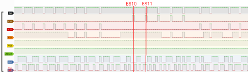

I have been looking at the chip select lines during the keyboard cycle and can see the PIA being addresses multiple times.
I think I worked it out.
E810 = b1110100000010000
With the address bits set like this /X8XX is H, /IO is L,
CS0=H, CS1=H, /CS2=L
RS0 = L, RS1 = L

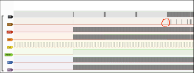

I can see this on the logic analyzer
Hmm. So PIA is being addressed.
