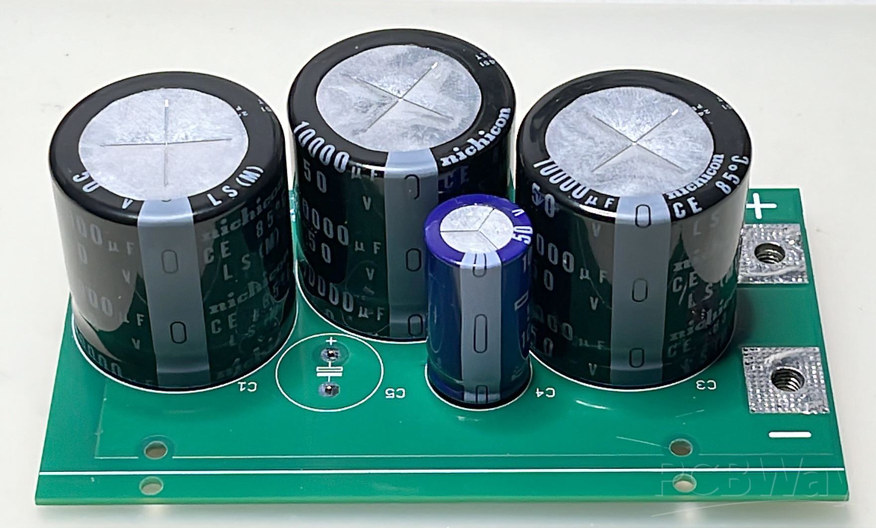

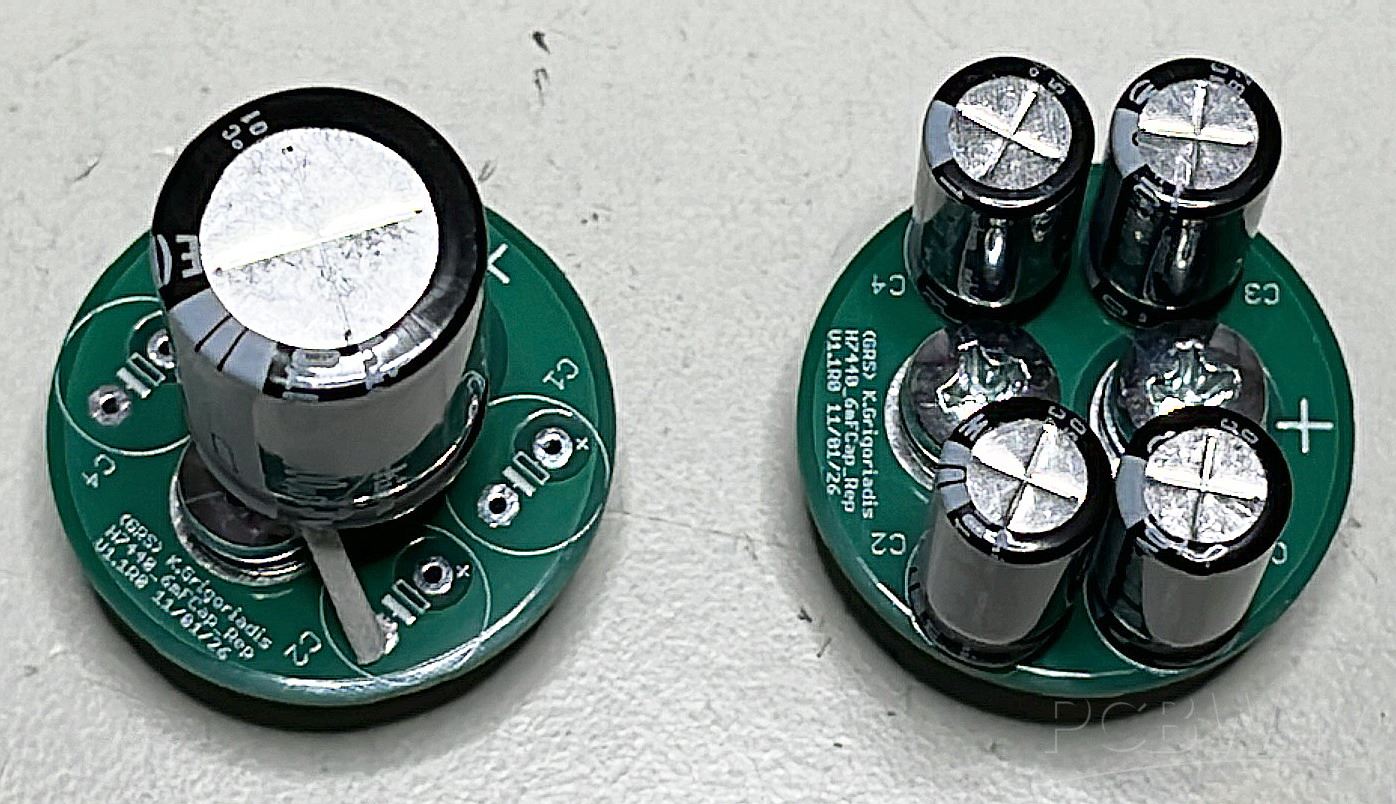

As we have in total five H7440 PSUs we started with these, to replace the capacitors. We want to use something which is suppoesed to work also in a few years from now. Therefor we created PCBs which fit at the original place of the big old capacitors.
First we created some mechanical models to see what is possible:
signal-2026-01-13-17-16-28-611.jpgsignal-2026-01-13-17-16-28-611-1.jpgsignal-2026-01-17-22-33-58-637.jpgsignal-2026-01-17-22-33-58-637-1.jpgsignal-2026-01-17-22-34-32-147.jpg
And after we decided what is the best solution, we produced PCBs which perfectly fit at the original places:
signal-2026-02-05-19-34-13-515.jpgsignal-2026-02-05-19-34-13-515-1.jpgsignal-2026-02-05-19-34-13-515-2.jpgsignal-2026-02-05-19-34-13-515-3.jpg
To be continued as soon as we made some tests under load ...
Now we have a proof of concept that it works.
Here the setup how wetested the PSU with the two replacement PCBs:
And here the video which my colleague Konstantin made during the test:
We will now upgrade all H7440 PSUs in the system before we create a similar solution for the the H781 and the H7850 PSUs.
To be continued ...
After our successful tests we will now rework a total of five H7440 PSUs in our PDP11/60
There will be some PCBs left after this.
If somebody is interested you can contact Konstantin directly or just let me know.

This is neat! Would you mind open-sourcing your PCB design and BOMs? I have a few H744s awaiting restoration, and i believe the 31000uF capacitor is exactly the same.
Hello, Thankyou!
I will probably Upload the Design Files (Gerbers, Schematics & BOM's) on the PCBWAY Shared Projects Page, and eventually later to the JLCPCB Shared Project page. Just for Info, I used 2oz Copper for these PCB's.
Mounting and the rest mechanics are shown in my Video.
Cheers,
Konstantin
Hello, Bellow the Links to the "my PCBWAY Shares Projects" Page with the Files for the 2 Replacement PCB's I designed,
for the Obsolete 31000uF Input and 6000uF Output Capacitors of the H74400 & H781 DEC PDP11/60 Buck Converter PSU's.
