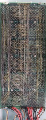

... we will first of all check the wire-wrap connections on the backplane which lead to the connector from the console panel:
To be continued ...
The KD11-K CPU backplane shows no visible errors:
During this inspection, we also reinstalled the missing NPG jumpers:

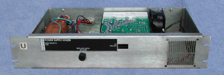

Indeed "modified". Between the fdan and the terminal strip should be an H7xx power brick.
Apparently the complete brick; I found this photo which I think is yours:
Note the rear 2x3 Molex. According to EK-FP11E-UG-001_FP11-E_Users_Guide_Dec77.pdf there should be a 9-pin Molex connector at the other end of the attachment cable and that only +5V is supplied.
Note that what is being described is an H7412A:
The diagrammed power distribution board is consistent with an earlier photo from @klapperp, before the SU harnesses were attached. I wonder what that board looks like now with all cables attached?
It seems that the "modifications" included bypassing the double-ended Molex cable as well as the power distribution board. Six differently colored leads to the Fast-on clips seems like a recipe to NOT get the right connections made to the SU?
Going back to @Henk's photo judging by the PCB solder-side etch that's an H7441 (32A) rather than either an H744 (25A) or H7440 (25A). That's a lot of juice for just four boards. Interesting!

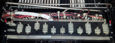

Are your FP11-E modules installed? How are you powering them?
shows the (auxiliary) FP11-E power supply connected to J4 rather than J5?
This is what it looked like before we took it apart for cleaning:
The connectors on S.U. #6 which are now new, belong to the formatter board inside the TS03 tape drive. We added an extra DD11-D backplane in the expansion card cage which uses the connectors from S.U. #5 and one connector from S.U. #6 and therefore we connected the power supply for this single external Unibus board here :)
Sticking with the original choice of socket makes complete sense, but the referenced document clearly states:
8. Locate socket J4 on the power distribution board inside the BA11-PA box.
9. Connect the +5 Vdc cable from the FP11-E power supply to socket J4 (Figure 8-4).
So it's not just "poor artwork". I find this whole approach to connecting the FP11-E power cable a bit disconcerting as the cable harness FROM the various power supplies connects to the backside of the distribution board and then the plugs to the various SU connect to the front -- which is the standard practice on these distribution boards. So there must be some special-case wiring between J4 and J5 on the backside that allows J4/J5 to be swapped (power in vs. power out) without ill effect _OR_ the FP11-E User Guide is very wrong. I'm left assuming that the cable that you have in J4 uniquely/exclusively supplies the four FP11-E slots (8-11), so J4/J5 is just a back-to-back pass-through from one male Molex plug to the other.
I did find the following distribution board photo that agrees with your wiring and shows the FP11-E power supply cable connecting to J5:
I will check this next time when I remove the cover from the card cage!
