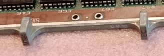

Thank you for the photos. As it happens there are multiple versions of M7984 MOS memory. The one in your photos appears to be the -Ex version (which should be specified on another of the metal handle-tabs) as it uses the MK4027N-3 4Kx1 200nS part, so a total of 16K x 39-bit (32-Kword) -- that's the MS11-KE according to my notes. Example tab markings:
There's also a higher-density -Fx version that uses a 16Kx1 200ns MOS RAM (not sure of the RAM part number), so a total of 32K x 39-bit (64-Kword) -- that's the MS11-KF according to my notes. Just two of those modules would max-out the capability of the M7983 memory controller (and the 11/60 address space). I put together the following M7984-XX / MS11-Kx cheat sheet at one point that might prove helpful in the future:
You are right, the 2nd metal handle-tab on all 4 memory modules shows "EC":
This will give us 128K-Word of memory when everything goes well.

FWIW, the second letter of the suffix on DEC memory boards of this era usually indicates the manufacturer of the RAM chips on the board.
I found it interesting that the example module appears to mix multiple manufacturers without obvious evidence of having resulted from chip replacements. The MS11-K FMPS is MP-00325. Online references: https://vt100.net/manx/part/dec/mp-00325-00/
M7984-EB21-13914-014K MOS RAM 16 PIN ICDEC (200NS)
M7984-EC21-13735-014K MOS RAM 16 PIN ICMOSTEK (200NS)
M7984-ED21-14114-014K MOS RAM 16 PIN ICMOTOROLA (200NS)
M7984-EE21-14475-014K MOS RAM 16 PIN ICFIJITSU (200NS)
It actually states "NO MIXING OF MOS CHIPS VENDORS ALLOWED". Hah!
I think it is more likely that some faulty RAM chips have been replaced during the systems first life.
@Konstantin told me that this was a common practice in the eighties and he made this as well in his job at that time.
I have no doubt, but the example photo seems to indicate quite a few replacements, e.g., none of those Motorola ICs belong there if that's truly an -EC board (could it be an indistinctly-marked -ED?), and yet they are the majority of the RAM ICs. Perhaps a photo of the back will make clear where any replacements took place?
