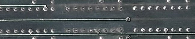

Thank you for the photos. So that mostly-Motorola module is an -ED after all. With three dozen Mostek replacements, done quite well as far as I can see from here. Only the 7th row, fourth from the right (as seen from the component side) looks like there is perhaps some flux residue on the solder side. Maybe manufacturing ran short of Motorola components that day and just stuffed randomly with on-hand Mostek?

From the rear side you can see the rework. Since the replaced parts also have DEC P/Ns on them, I'm guessing this was depot-level repair long enough ago that the chips were expensive enough that it made sense to do that level of rework.

I can't, but I'll take your word for it :-}. So that's what a depot-level repair looks like. Sure was extensive, but mighty clean. What's your hypothesis for having three dozen chip failures? Perhaps all turned out to be marginal WRT timing requirements? How would they have gone about detecting and localizing each of them, then?

For example, the center chip in this picture (the -4 board above, to the right of the centerline caps, 7th row down):
It's possible they had some automated test equipment. Or maybe there was a mix of date codes in the memory chips and they just knew to shotgun-replace all memory chips with that date code.
