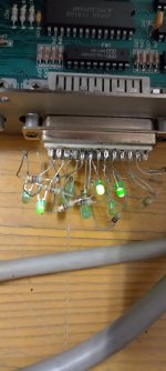

A port 80h POST card is of no help at all. The Olivetti PC bios doesn't use it. Instead (other Olivetti PC) use the parallel printer port. But I never tried that with the ETV 260 or M19, so I don't know if this would work.

No. It does not use the handshake signals to tell the printer there is something. It only uses the data lines. It must be a special device which still might be available on eBay. (search for "Olivetti parallel port"), it has some LED numeric display.

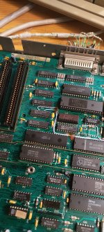

I opened it again as said before and I tried to remove one a time all the chips mounted on a socket (I think I have already done it once, but I wasn't sure so I did it again). Nothing changed. The only difference I could note is that removing this memory (TMM24128AP, I suppose it's where the POST routine is written) the board really does nothing at all. Not the little buzz at the starting up, no leds on the serial port and no response from the led on the keyboard.
Am I hoping too much?
I also checked again all the voltages on the main ICs. They all seems good: 5V everywhere. I also checked the clock pin on the processor with the oscilloscope and I read 4.something MHz (I'm quite sure it's right) and both the address lines and the data lines have signals on them (almost like periodic square waves but not so periodic to let the scope trigger correctly... I hope it can be undestand what I'm meaning).

The system would also boot without monitor. Good, that it (and M19) uses parallel port to display POST diagnostics. This POST on parallel port ends when the system is able to access video ram and continues there with the status display, like all other contemporary Olivett PC. We now can hope that it's the same codes as M24 Bios. You must decode them to their hexadecimal values.
For M24 I have:
If you want it more simple you may order such a device, it works nice with M24 and so it also should work with ETV 260 (and M19)
So, from the photo I sent, if I'm reading it correctly, and also in this case the codes begin with a 4, the error code is 43. Is it correct? Meaning that the DMA controller is faulty? Or is it more probable the ram chips are faulty or something else related? Where do you think can be find a similar error code's list for, at least, the M19? Google is not helping me at all...
This is the only known list for early Olivetti PC. They might have not changed the meaning of the codes. I would start to search with the DMA controller. The big problem is, there is no circuit diagram for M19 / ETV 260 mainboard. Easiest might be to replace the DMA controller if you have one.

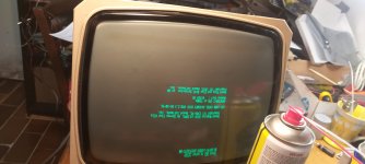

The new DMA controller is on it's way. In the while I tried to fix the monitor with quite a good result I think. At the end I had to replace almost all the other electrolytics. They were completely out of tolerance or with crazy ESR, as you said 1ST1. I also had to change a transistor, a BC337, on the the section of the beam controller (contrast/luminance). After that, it came back to life. The only thing that puzzle me is that using a normal CGA card it does not sync properly. The image never stabilize vertically, while horizontally it sync perfectly with the minimum regulations on the horizontal hold and then when the circuitry warms up never sync properly again horizontally. Is it normal or do I have to search for any other faults?
VERY GOOD!
The ETV 260 and M19 PC are using different Video frequency as normal CGA. You can't use a standard CGA monitor on that and you can't use that monitor on another computer. Even M19 and ETV 260 might not be monitor compatible to each other as M19 which is the base mainboard for ETV 260 is only 4.77 MHz. The video part on both mainboards is a bit different. Additionally there is ETV 3000 which looks the same as ETV 260, but it again is different in the video part of the mainboard as it can support ETV 2700 monitor (with different timinng) with a composite video connector. It's even hard to get a multisync monitor to work with. And the signal is also not the same as on a standard CGA. That is digital RGB, but ETV 260 is more like MDA, videosignal plus intensity.

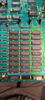

Yesterday also arrived the new DMA controller. I changed it and nothing happened different from the original. Reading on your links that the DMA controller tries to use the first 64K of ram to set itself up, I had the idea to give it a surely working 64k... So I removed and put the sockets on all the first column on DRAM (41256 type) and instead of those one, I put 8 new 4164 (spares I bought some time ago to fix a commodore 64. I checked the pinout and except for pin 1 - A8 for the 41256 and NC for 4164 - they looked compatible even from the timing chart, so I said, why not.... XD) and a "magic" happened! The error code changed and arrived to 45!!! I attach the photo and a video. But even, no bip or anything on screen... Same result using the new or the old controller.
Is this a good thing in your opinion? And what should I do in your experience now? Is it better to find a new set of 41256 for the first bank or for now just leave the 4164s there and go on troubleshooting the rest?
