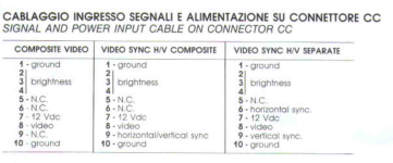

The ETV 260 system probably connects per option 3, separate h/v sync.
Yes, this is what I thought. It's quite similar to that monitor I attached the schematic, but it's not the same. The pinout of the monitor connector (a DB9) is this one: 1-2=GND 3=NC 4=GND 5=+12Vdc 6=Intensity (but it's like to be unused for what I understood) 7=Video Signal 8=H Sync 9=V Sync. For what I saw on the board, the ETV screen and the schematic I attached, share the IC for the vertical and horizontal deflection and almost all the ETH part, while the rest is quite similar as working idea but not the same because of the use of various 74xx logic chips. I got the pinout here checking it with the tester and seeing the connection to the monitor board and on this one I read the silkscreen to understand the different function. About the intensity, on the board is written just "N". So I tought it was meaning something like "nuance", similar in meaning to intensity... Just a guess.
To connect it to the CGA card (an isa 8bit card from aliexpress, like this one https://it.aliexpress.com/item/1005006036994388.html) I made a little adapter moving the video signal from one the rgb channel (pin 3,4 and 5 of a normal cga connector) to pin 7 and it worked. The only thing I noted is that it's never completely in sync vertically and it syncs horizontally only when all is "cold" and the horizontal hold to the minimum and the horizontal phase quite to the minimum (or both maximum, I always have a dubt while talking of trimmers...). After a few minutes, just the time for the monitor's board to warm up, and horizontally it gets completely out of sync too. But, one thing is sure, the timing charts of that manual is exactly the same for this monitor, same shapes, peaks and almost timing and in the same points of the circuits. The way the trimmers are soldered on the board are completely different.
That does correspond to monochrome M19 MDA pinout, except the pin 5.
Figuring out whether Intensity is used could reveal nature of the signal/monitor. If it isn't all bets are on composite video data on pin 7 and separate TTL h/v sync.

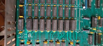

I also changed back, one by one, the 41256 dram chips. I found the faulty one! just one and I left on a 4164. And I almost cried: the computer finally beeped!!!!!!!!!! Started the video and finally I had an image! It got stuck there. The keyboard respond correctly to caps lock and similar keys.
I ordered 10 new 41256 chips from China... They should arrive at the beginning of March. It show the codes flashing across the parallel port and then revert back to a fixed one.

So, here is the photo of first bank of rams totally on the sockets: only one chip was faulty of all of the rams.IMG_20260327_212908.jpg

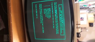

And here the two photos of the signalIMG_20260327_213459.jpgIMG_20260327_214147.jpg
I'm sorry but I don't have a digital scope yet... So, this is the max I can obtain.
I attached also a couple of video of the system booting and working.

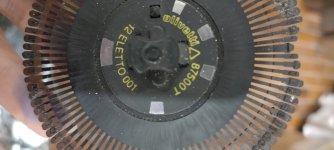

Very good! Which language you would need? Currently I have only image of german ETV 260 disk, and it may complain about a foreign daisywheel. The ETV 260 has software driven printer, all done by DOS drivers and the language of the driver must match keyboard and daisywheel. I also have italian ETV 3000 disk, but I don't know if that would work with ETV 260.

I would like the italian one, but any would be wonderful. I attach the photo of the daisywheel that it's actually in the machine. Maybe we can try with both of them (I mean the 260 and 3000 disks) if it doesn't bother you too much. I will start cleaning all the mechanic soon. What do you recommend as lubrificant?

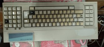

I attach also the photo of the keyboard. You can see the missing keys. Do you know what those keys are?
