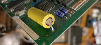

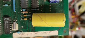

Ohhh!!!! That's great! It's a really interesting system to detect the daisywheel. Thanks so much for the images!!!! Do you know what it should be this thing on the control board? I think is a battery of some kind but it measures 0V... I've disconnected it because I don't want to risk it will leak any acid. But... I'm not sure what to do about it. What do you recommend?
That's a rechargeable battery to keep some settings for the typewriter mode. I haven't seen yet that it leaked, but if you like you can put it on a cable and place it elsewhere away from the boards.
