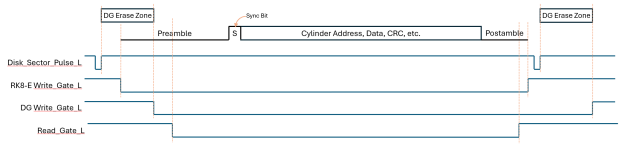

The ".rk05" disk container consists of a container header and sector data.
The RK8E style ".rk05" sector data is simple:
2 bytes little endian cylinder number
512 bytes sector payload
2 bytes little endian CRC16
The disk container header contains a bunch of settings controlling the behaviour of the FPGA - see C function "write_image_file_header()" and lines 68 - 77 of RK05Util.cpp.
This header will have to be specific for each type of disk controller. My initial focus was RK8E only, but I have started thinking about a clean way of extending this to other formats. There will be support for Xerox Alto, DG 4047/4049 and RK11-D/E.
If you need something quickly, then it wouldn't take much effort to hack the source files to support your 12-sector format. If you can wait, then I will add the functionality to support all formats. I would appreciate your help testing this.

Sorry @Nevets01 I just realised that I got the 512 bytes sector payload wrong - that should have been 384 bytes - i.e. (256 * 12) / 8.
Of course these numbers are only for the RK8-E (PDP-8/e).
is...
char controller[100] = "RK8-E";
int bitRate = 1440000;
int preamble1Length = 120;
int preamble2Length = 82;
int dataLength = 3104;
int postambleLength = 36;
int numberOfCylinders = 203;
int numberOfSectorsPerTrack = 16;
int numberOfHeads = 2;
int microsecondsPerSector = 2500;
Okay, so controller is just an identifier string.
bitRate, numberOfCylinders, NumberOfHeads, and microsecondsPerSector are all things that wouldn't change from drive to drive... though them being redefinable would make this useful for emulating other drives that aren't necessarily compatible (e.g. Diablo 44).
numberOfSectorsPerTrack would obviously change on a pack-to-pack basis.
That leaves preamble[1|2]Length, dataLength, and postambleLength. What are these? From the names, and the fact that I haven't been able to find any mention of them in the RK05 or Diablo 31 manuals, it sounds almost like the 'preamble' and 'postamble' are sequences of data written onto the disk by the computer, (rather than something inherent to the drive), and instead of just writing all the data that would normally be written onto the disk pack, onto the image file, the emulator is detecting that data on a write operation, excluding it from the data written to the image file, and generating a synthetic preamble and postamble when reading the data back. Is that guess correct?
That approach would certainly explain the need for a controller-specific (and possibly software-specific if there are platforms that leave the pre/postamble up to the software) header, so the emulator knew what data to ignore on a write operation, and what data to generate on a read operation, since these would differ depending on the controller/computer/software.
Either way, thank you for the info!

If I remember my Diablo 44 bits correctly, preamble1 is a bit pattern saying "sector header coming up", then there's some header bytes that get written by the formatter, preamble2 is a bit pattern saying "sector data coming up", and postamble is just a gap to deal with variations in spindle speed, write speed by the controller, etc. so that a "slow" write doesn't spill over and corrupt the following sector.
Most of the controllers that I've looked at that work with the Diablo Model 31 and RK05 have the following format and timing:
It has an all-zero preamble of some length followed by a Sync Bit which is a "1", followed by some other fields and data, followed by an all-zero postamble.
The Read Gate and Write Gate go active between the sector pulses. That is, except for the Data General controller which keeps Write Gate asserted past the sector pulse.
Bit rates vary. I've seen 1.440, 1.545, and 1.600 Mbps.

Sure. My point was that since the RK05 is hard sectors (12 for PDP-11 and 16 for PDP-8), you shouldn’t need to know what the controller is doing for the meta-data.
I agree it should be possible to have it format-agnostic, except that you need to to know the bit rate that the controller is expecting. Unlike magnetic media a simulator need to know the bit rate ( unless you over engineer it and sample the signal at lets say 10x and the reconstruct the bit stream ). What I meant was that unlike SMD / ESDI where the drive is in charge of clocking the controller is in charge for RK05 which means that we at least must match that in the simulator. So some metadata about the controller has to be known by a RK05 emulator.
I agree you need to specify the bit rate as that drives a lot of things but you should know that by the density of the pack and it's rotational speed (50Hz drives spin the platter at the same speed as 60Hz drives because the pulley on the motor is of different sizes...they're marked with the intended line frequency).
But my argument is that you only need to specify the bit rate. You don't need to specify pre/post ambles as that's all managed by the controller and not the RK05 drive.
