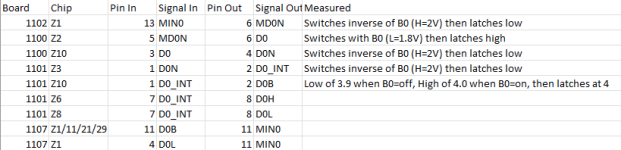

So for context, tracing the data bit 0 signal in relation to memory, I made this table:
For reference, schematics can be found for all boards on SCELBI.com
If I don't mention what the logic level high is, it's 5V (or whatever voltage I'm getting in)
If I don't mention what the logic level low is, it's 0V
I saw no difference in logic levels with or without the RAM cards plugged in
On notes where I mention "then latches X", the logic level toggled with the switch when the Int and first status lamp were lit (prior to memory write) and then latched during the memory write operation (both status lamps lit)
What I think is happening is that at Z10 on board 1101, our high and low voltages are too close and getting mixed up.
And I think this is caused by our weird logic low of 2V situation on card 1100, which is the CPU card. And this is where I see something I do NOT understand. The pull-down network on the data-bus:
(Again, full schematics can be found at the SCELBI.com link I mentioned earlier)
What is this? I'm pretty sure this is why our logic low only gets pulled down to 2V. Now something itneresting about this is that it seems these tended to be 3k resistors in reality. (As mentioned in the link to Mike's blog linked earlier) Some of my resistors seem closer to 3.5k than 3.3k, so I'm wondering if things are just very marginal/sensitive about this diesign.

The pull-downs look wrong to me.
The Mark-8 schematics have pull-ups.
The Intel schematics have pull-downs, but a transistor switch making them a pull-up under certain circumstances.
Anything that should be logic HIGH between 0.8 Volts and (say) 3.5 Volts would be suspect in my book.
As you have already found, you need thick cables on the power supply leads!
The voltage on the logic devices should be greater than 4.75 Volts.
Are your Z1 and Z10 buffers 74L04 devices? The 'L' is important, LOW power.
Z2 and Z3 are open collector outputs - so do not 'provide' a high output voltage. They rely on external resistors to 'pull-up' the data bus of the 8008 CPU when the CPU is reading data from the data bus.
This further supports the thought that the data bus resistors should be pull-ups to +5V and not pull-downs.
EDIT: The SCELBI is the same as the Intel schematic with a transistor switch to +5V. Is the logic working that drives the transistor, and have you installed the transistor the correct way around? Note that some manufacturers have different transistor pinouts to others for the same part!

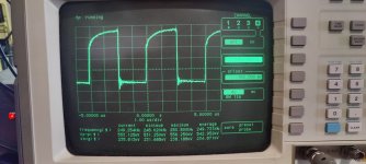

I can probe 5V accross the cards with my oscilloscope and see if I see noise. FWIW I just did so on the ROM board (since it was easy to access) and didn't see anything. But that has decoupling capacitors on it.
Mike had told me via email that the logic high of 2V could be due to a blown 74XX logic chip outout or the open collector not getting pulled up, which sounds right. I don't see any more missing pull-ups. But I'm thinking it'd be worth
1. Checking the chips with my XGPro to make sure they are functioning logically. Specifically the ones in the path of the stuck bit.
2. Check that they're not still attempting to pull the voltage lowish.
Perhaps validating these readings with the scope would also help. Maybe said noise is causing the logic high to bounce around and read as 2V on the meter. Another thing to check I guess.
I just probed 1102 Z1 pin 6 for MD0N and it turns out that yes, that is why the meter only read ~2V.
Looking at this signal, I actually think it is operating as intended now. (When adequately powered)
Remember the 8008 multiplexes its pins between data and address. The 250kHz signal we see is it multiplexing between data being set to 1 and the address being set to 0. If I set switch B0 to 0 on address 0, it's at steady ground. If I set switch B0 to 1 on address 1, it's steady 5V. If they don't match, we see the multiplexing.
With this in mind, I am not worried that I have further issues with this stuck bit to resolve aside from getting adequate power to the system.
