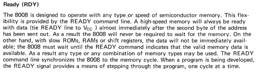

I have a solid idea of why the system is stopped. Pin 17 on the 8008 is the ready signal. The CPU is waiting for the ready signal:
I have confirmed on the scope that it is being held low. However, I'm trying to understand the run/wait circuit to figure out what is stopping the system. It seems plausibly memory related based on this, but the circuitry for this is quite complicated. I am currently trying to understand it such that I can dig deeper into what is going on and how to fix it.

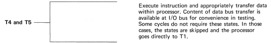

The ready signal to the CPU comes from some circuitry in the bottom-right of the CPU board schematic. That takes inputs of the sync signal, the step button, the run button and "T1IN"
T1IN comes from a 4-bit BCD to decimal decoder. (Only using 3-bits) Ultimately, T1IN is stet to high whenever all three status pins on the CPU are high.
This indicates we are in T4.
Which per my last message is this:
So if I'm not mistaking, this indicates that the CPU will put itself into this state anytime we execute an instruction that requires these states. Which I'm not exactly sure which ones these are or why this would be wanted. Unless I'm misunderstanding something here.

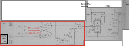

A lot of the interrupt circuit is easier to understand when you realize that INTC and TTY are both grounded in the chassis. Meaning a lot of the circuitry ends up just inverting the INT button.
That goes into some D flip-flops that can only be set by the INT button but can be cleared through some other circuit. But that means nothing else can set the interrupt besides the button.
