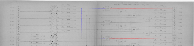

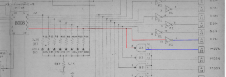

The DBB data path for D7, which connects to the light on the front panel, is here:
And on the CPU card it's here:
Curiously, if I remove Z3 from the CPU board, it's still stuck high. But without Z3 and the CPU, there's nothing to drive a high signal here.
Also, I do note that Z9 on the DBB board is controlled as follows:
Pin 13 is tied to Z15 pin 12, which is the D3 signal for some reason. I was wondering if maybe D3 wasn't switching, so C wasn't going high, but this isn't the case.
All logic chips in the D7 path check out. I believe it's the same for D3.

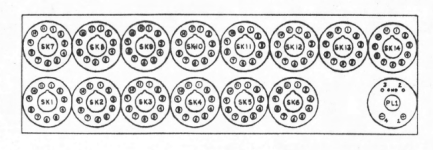

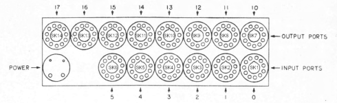

Here is the strobe wiring:
Here are the output port and socket numbers:
Combined:
So, OUT6 is SK13 which should be wired to A21 on the DBB which is OS6. Even though it's output port 16 which should be pin AY. But also instead we're seeing port 13 strobed which would be pin AV on the DBB which should go to OUT2, but actually OUT2 goes to A17. Confusing.

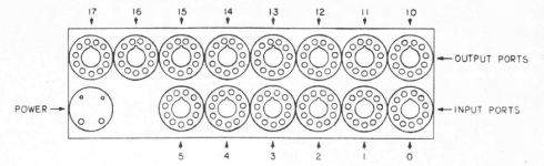

In the MEA manual you can see the discrepancy with the output port being described as both 16 and 6:
Yeah, so "OUT6" in the MEA manual refers to how the chassis is labeled.
This example is from the SCELBI registry. Aside from some obvious modifications, it should show that labeling well enough. Note the layout diagrams I referenced in my last post are actually upside down.
So OUT6 as labeled aligns with output port 16 per that diagram. Socket 13.
So I guess then if we start at octal 10, then it makes sense that OUT6 is output 16. So I guess that makes sense sorta? Then the SCELBI-8H manual shows instructions for output 6 but it's probably the 8008 instruction for output 16.
