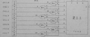

I probed Z11 and can confirm that D is in fact toggling on it:
So that's 0101 or 5. Which is pin 6 of Z11:
Which goes to to OS15 on pin AX.
I will next probe this pin. If it works, I might swap one of the strobe pins on an existing socket for it and see if serial works that way. I still think something is fishy, but if it gets me serial then it gets me serial.
AX is held low.
BU (OPSN) is held high. This is the other input to that NOR gate. So that makes sense that AX is low then. Hmmm
If I toggle in 135 though, which is output to oct 16 ("OUT6")

Not still sure what Z11 on the buffer/output card actually does for us. It is almost as though it should decode for another range of output ports, but I can't see (yet) how it does...
It looks to me like D4 is selecting either Z11 or Z12 via this:
Specifically, Z16 pin 9 / Z13 Pin 2 originates ultimately from D4N

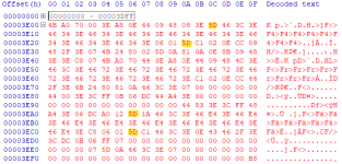

OUT 16 = Octal 135 = Hex 5D
This shows up four times in the TTY ROM at addresses
HexOctal
3E0CP: 76 A: 014
3E2AP: 76 A: 052
3EA6P: 76 A: 246
3EC6P: 76 A: 306
I can check these to see if they actually read 5D.
EDIT: Yes, we are getting 135 at all four of those addresses.

I think I have worked out the 'magic' for the second output decode IC (Z11) - it is done in the CPU card via the OPSN signal driving the buffer/output card via the BU pin. This aligns with your oscilloscope trace in post #84. OPSN goes LOW (to enable the decoded strobe outputs) and the selected strobe (pin A12 OS6) goes HIGH.
D4H is still used to decode whether Z11 or Z12 are actually enabled (via their 'D' input). But the outputs are only enabled (via the OPSN signal and the following NOR gates) to signal the outside world.
